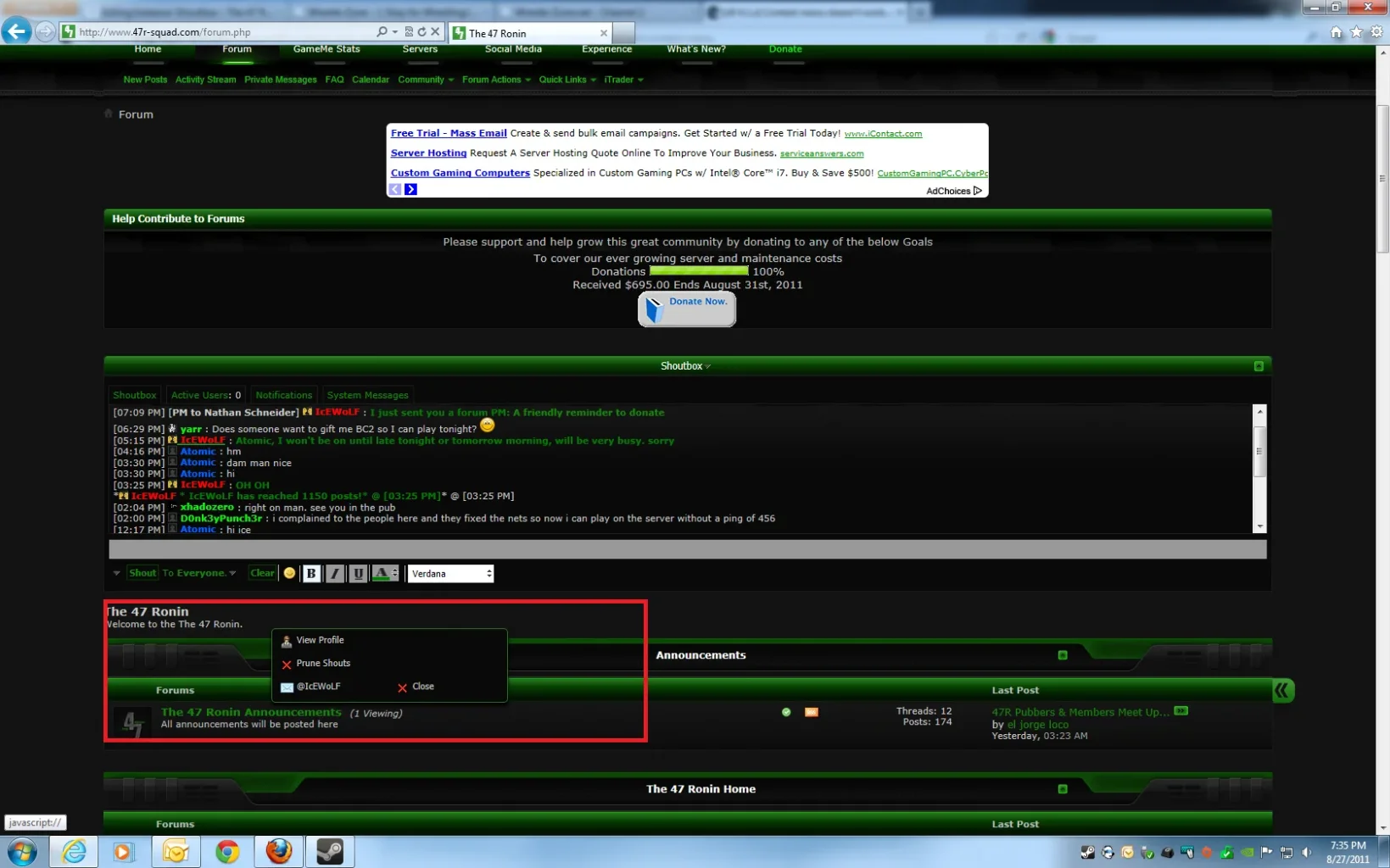

Ozzy, could you also look into this for me:
The menu should appear on the chatbox, not all the way down there :/
