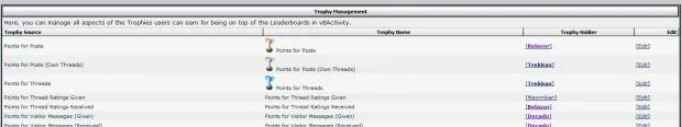

I just set up images to go with each trophy name. Is there something I am supposed to do to make all of these show up now?
I rebuilt cache and recalc achievemnts and they are still not showing up. I am still getting user n/a in the who has trophy spot under manage trophies.

ok firstly you set up your images using the info in Screenshot Trophy2.gif. when you've done that you'll be able to see the image next to the trophie you've made it for. (see trophy1.gif).
If any of the things show N/A as the trophy holder it means that no one has yet gained the right criteria for that trophy in our trophies bit you can see theres one for "points for posting" which whoever has the highest post count will have that trophy, if someone is supposed to have a trophy and doesn't i'm sure myself,Cosmic or fillip would be happy to hop over to your forums and check it out further (fillip would be your best bet).

Okay this is how I have it set up.
And they all show NA.
Not even the one with most posts shows up. Someone hs to have that one. And the trophy tab in activity menu is missing. I tried schedule task for it and it caused a database area.
