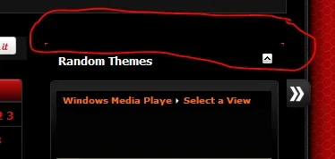

There seems to be only 2 small issues I still see. The first one, is that the sideblock seems to be without any header blocks now:

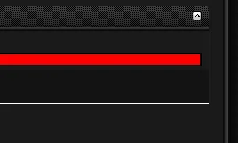

And the second is that on some skins the bar at the top now has a white border. And I cannot get it to change in the Stylevars also:

Na don't worry about bugging me, I want the product to be right and the customer to be happy.
I fixed the issue with the the sideblock that you reported.
If you want to change the color of that border around the contribution goal block edit the stylevar shade_color under the group Global.
Same thing Papa Bear If you want to change the color of that border around the contribution goal block edit the stylevar shade_color under the group Global.
