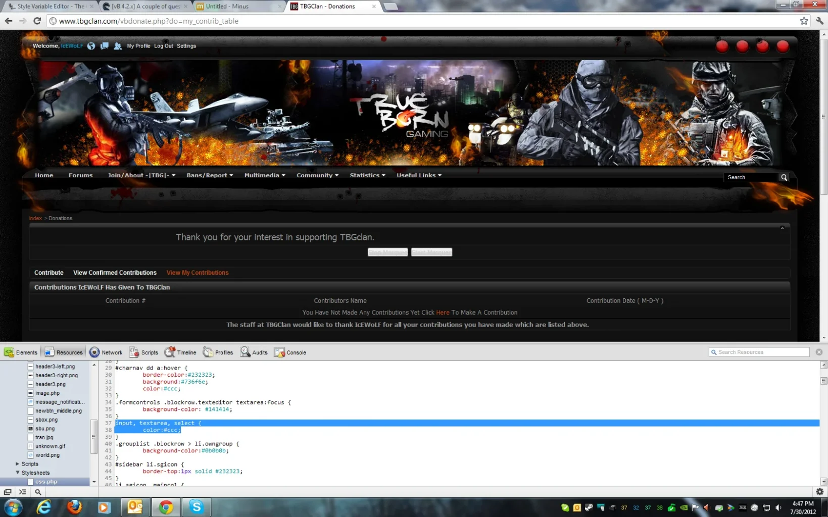

How do i change the color on the following

Hmmm, actually I think you may have to add a custom script in additional.css, Ozzy, would it be possibly to add something in the next release the color for the Marquee
In the next release I will change it so the background color of the buttons will be controlled by the stylevar, control_background (normal state) and control_hover_background (hover state) and control_color (font color) I forgot to add a class to those buttons.

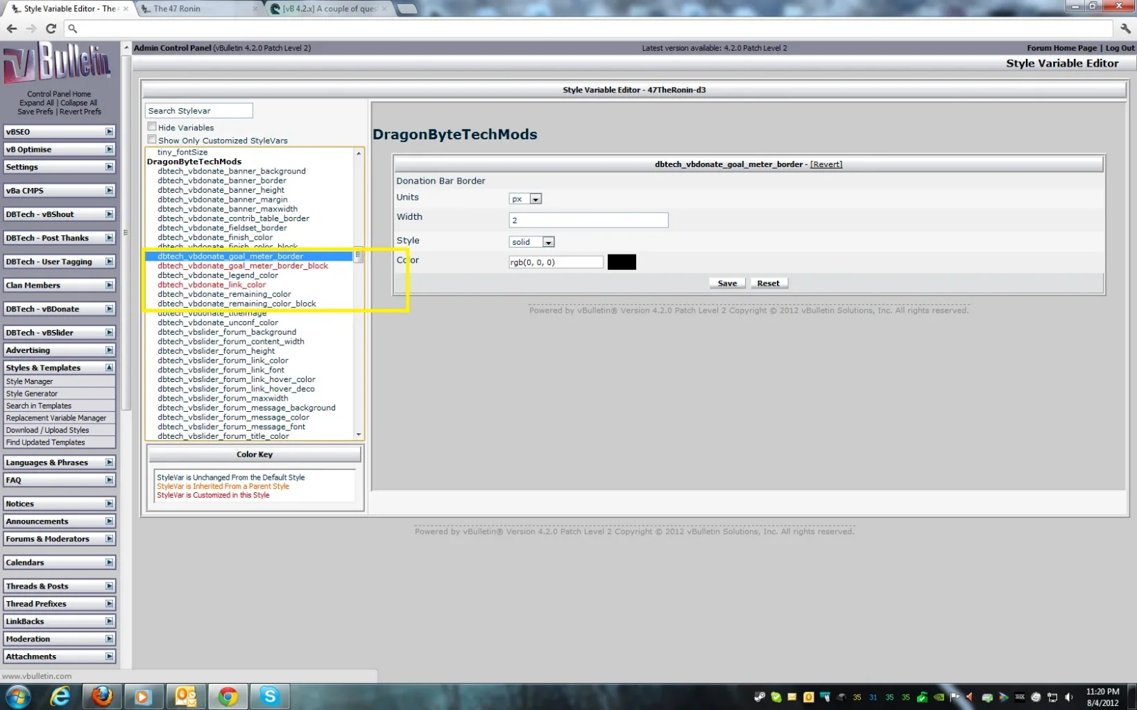

cool stuff, if i upgrade to the next version (whenever that is) will it be overwritten? As in will i lose the meter for VBA?
Also how would i go around to alter the colors for the meter?
THanks for the help
Well I have it showing correctly now, I had to change my process_templates_complete hook from a execution order of 5 to 7, seems there is another mod interfering with it, I will try to see which one in the morning.
I think he probably had AWCoding probably installed still, I think that's the reason why it's affecting this.
THanks for the help
I doubt it will overwrite those settings in the next version, the next version will have the fixes to address the above issues.
To edit the colors you will have to edit stylevars in admincp:
As IcEWoLF said, dbtech_vbdonate_finish_color_block, dbtech_vbdonate_goal_meter_border_block, dbtech_vbdonate_goal_meter_border_block under the group, DragonByteTechMods are the three stylevars to change there.
