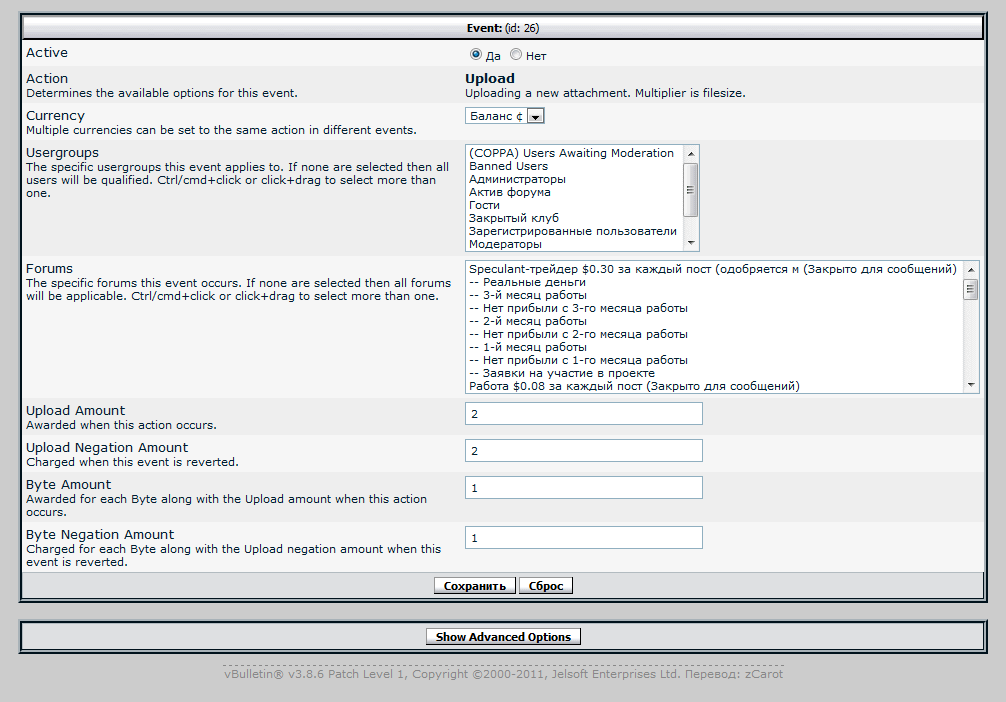

Here is how I have setup the upload event:
Can this issue have anything to do with the fact that I have configured all the uploads to be stored outside the "forum" folder?
That shouldn't matter. Do you get any errors? Does it interrupt the upload process? Does it work if you specified a remote url as the image vs uploading from your computer?

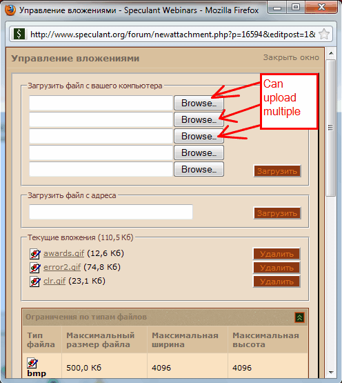

2) More important: on my forum users can upload multiple (up to 5) attachments in one click of the button "Upload" (see attached image). But they only get credits awarded as if they did 1 upload. Moreover, credits are reduced for every single of these attachments when they are deleted one-by-one. Can you somehow fix this bug? So that when the "Upload" button is pressed the system counts the number of files being uploaded
3) MOST IMPORTANT: am I right that the way you coded it was by making the credits system be triggered when the upload form is submitted regardless of the result? This explains the above issue, plus the next one: if a user tries to submit a file with an invalid format or tries to attach a web-file with an invalid address, presses the "Upload" button - nothing is submitted, he gets an error, BUT THE CREDITS ARE AWARDED! This is a very serious issue. Users can use this loophole to gain unlimited credits. The upload event is unusable unless this is fixed.
