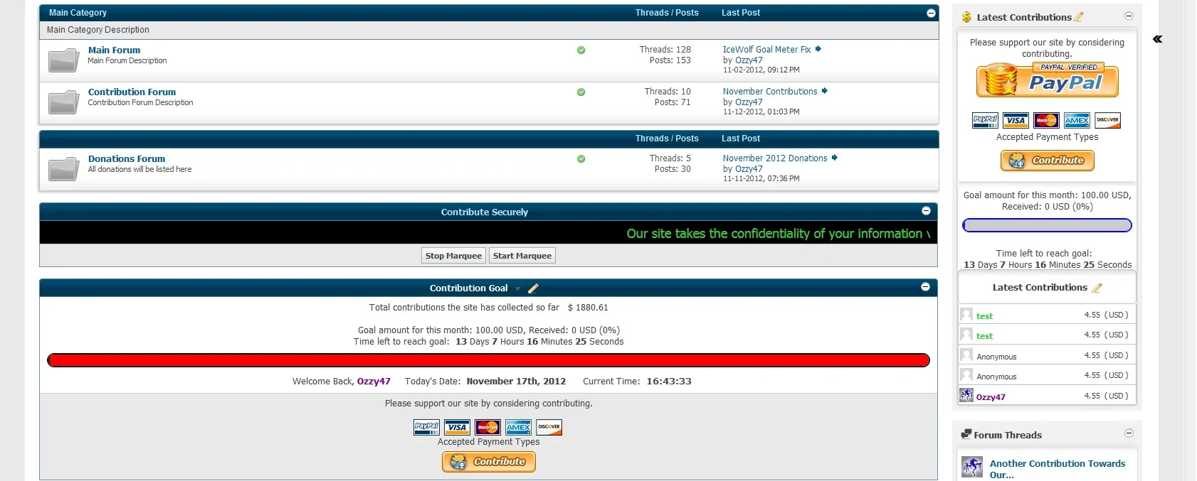

As far as the sideblocks, we code all ours to vBulletin standards, but I will look into it and see if there is anything I can come up with.
i have a forum sidebar, so this meaning it is fluid, or not?
or is the width meaning...sorry i`m new to this VB-stuff...
Yeah fluid, the forums go almost all the way across the page:
With a fixed skin they don't:
The issue you are having with the sideblocks it that that skin developer has coded their own templates to use, thus making any mods that don't have the additional code in them look like that.
So what you will have to do is edit each sideblock template and find a line that looks something like this:
<span class="blocktitle">{vb:rawphrase dbtech_vbdonate_latest_dons}</span>
Then after that line add the following:
<div class="clear"></div>
So it would look like this:
It is not a bug in our products, that is just how the skin developer did it.

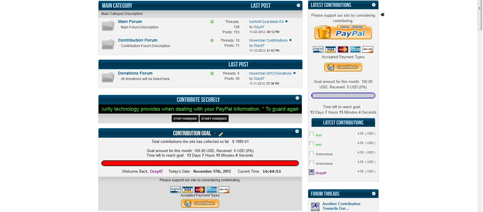

Draffi actually I found a easier way than editing all the block templates, in you style open the additional.css template found in the group CSS Templates and look for this bit of code:
#sidebar_container .blocksubhead,
#sidebar_container .blocksubhead.smaller {
	background: {vb:stylevar notices_shadow_color} url({vb:stylevar imgdir_misc}/head_bg.png) repeat-x top;
	color: {vb:stylevar blockhead_color};
	font-family: {vb:stylevar blockhead_font};
	font-weight: normal;
	font-size: 20px;
	text-transform: uppercase;
	text-shadow: 0 0 0 transparent, 0px 1px 0px #000000;
	padding: 4px 10px;
	height: auto !important;
	border-left: 1px solid #dddddd;
	border-top: 1px solid #dddddd;
	border-right: 1px solid #dddddd;
	border-top-left-radius: 5px;
	border-top-right-radius: 5px;
	background-clip: padding-box;
And change it to this:
	font-size: 20px;
	padding: 4px 10px;
        overflow: hidden;
That is how I think the skin developer should have done it instead of adding extra code to the block templates.

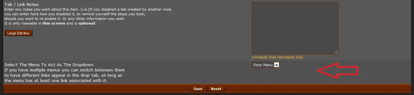

After you created the tab, and the menu for the tab did you go back and edit the tab you created? It should be all the way down just above the Save Reset line:

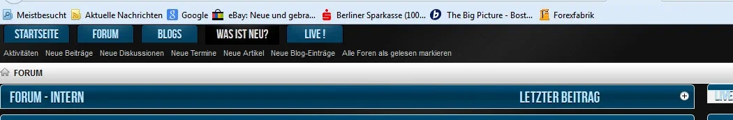

But in this theme i have only a Sub-Menu under the navbar, no dropdown-menu...Or i doing something wrong?

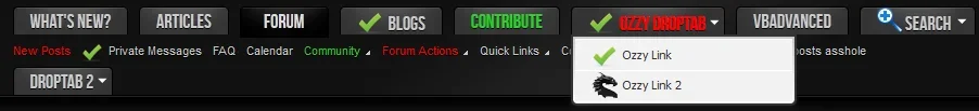

Did you add any links to the menu? the end result should look something like this:
Ozzy Droptab (Tab) That is the tab
Ozzy Menu (Menu) That is the menu you made for that tab
Ozzy Link (Link) That is a item in the dropdown
Ozzy Link 2 (Link) That is another item in the dropdown
