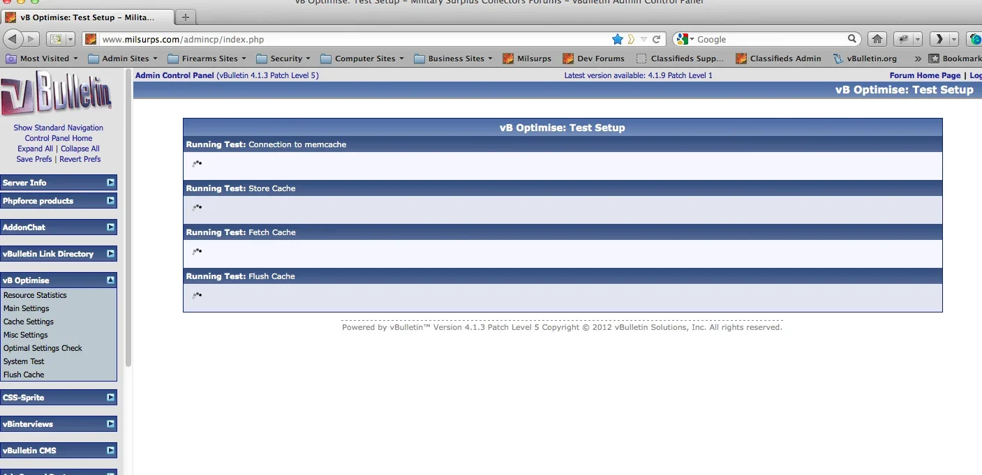

Follow up ...
Actually, the word "fail" is probably not technically correct ...
I simply sits and spins, doing nothing (see pic)

That's not a problem in vB Optimise, something is preventing the AJAX calls that vBO performs for its self check to fail.
Have you installed any new products lately? Try disabling all other products other than vBO and see if that helps

So, even though the self test fails, the vbOptimize is still running properly?
I haven't installed anything new, except upgrading from 4.1.3pl1 to 4.1.3pl5...

That doesn't exclude that there could be a mod conflict. vBO has error handling for its JS, if it keeps spinning forever it means that something not inherently wrong with vBO has happened.
