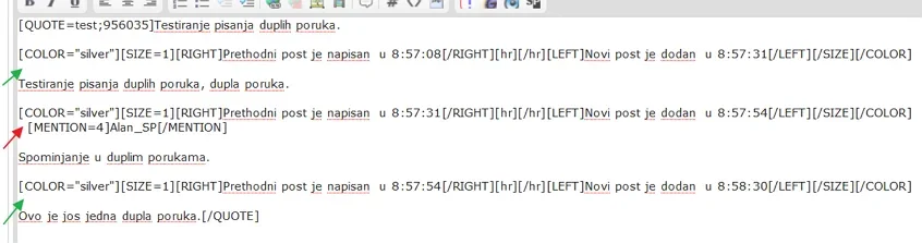

Just to add this new info. I'll show you with picture:
You can see that mentioning BBcode (pointed with red arrow) doesn't parse two new lines, but normal text parsed two new lines (pointed with green arrow). Mentioning made two spaces after new line. I now use this code for spacer line:
