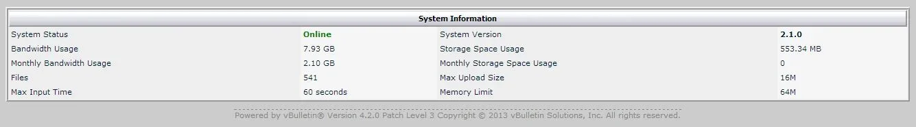

Can you show me a screenshot of your System Information page in the AdminCP?
