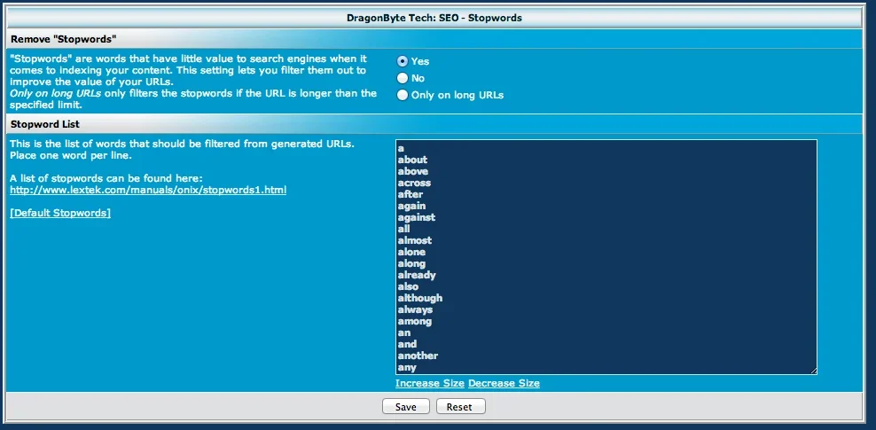

HI. We currently are seeing a problem with Stop Words.
For example:
http://my.server.com/help-with-splitting-and-rearranging/shell-programming-and-scripting/t238897/post302866875/#post302866875
We see the "and" stop word in both [thread-title] and [forum-title] (above)
FYI, the format for this test is:
http://my.server.com/[thread_title]/[forum_title]/t[thread_id]/post[post_id]/#post[post_id]
What's the name of the URL Format setting you edited to produce that URL? I'll need to know so that I can look at the specific code that generates that URL.
I'm unable to replicate any issues with that particular format or indeed any other thread format. Can you please double-check your settings and ensure you gave me the correct format name based on the format setting you showed me in post #1 ?

Settings:
URL Rewrite Settings -> Forum URLs -> Thread URL - Custom
Custom Thread URL
You can see the URL after DBSEO matches perfectly the Custom Thread URL format, but the Stop Words are in the URL.
Cheers.
