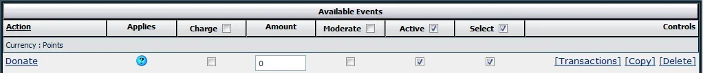

Are you sure you have an active Donate event? If you have both, they will be be in a dropdown to choose from, not one suppressing the other.
If it is missing, just add one. If it is there, please post a screenshot of it expanded here, so I can look it over for you.
I have made sure the donate event is active. You can see the "change:" link for the "to:" account in the second screenshot. When clicked, a text box opens up for editing where the username is, and it's changeable to any username on the site.
This option is not there for the "from:" account.

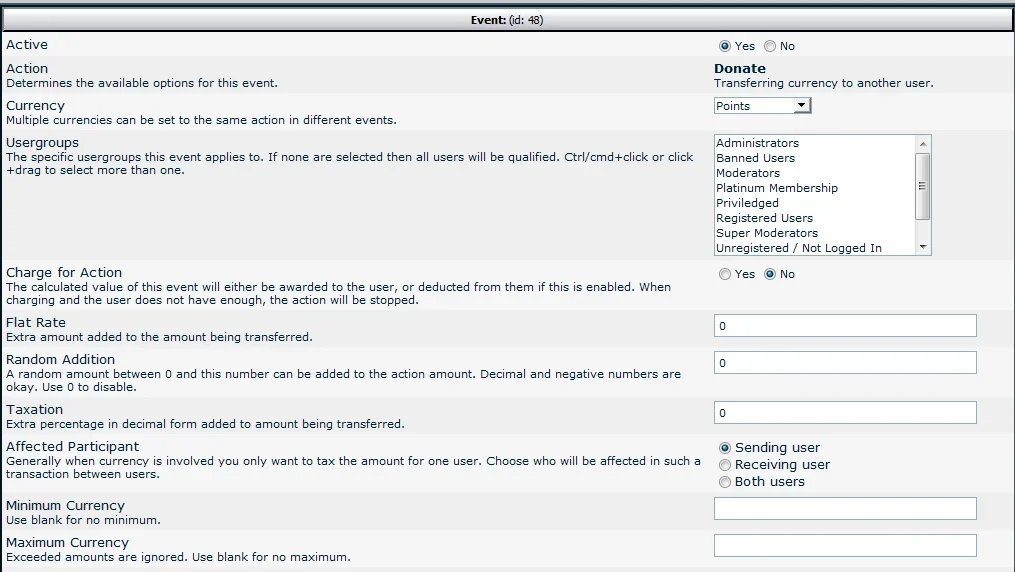

From the first screenshot, can you click the word Donate and then the Show Advanced Options button at the bottom of the page that loads. Then take a screenshot of the form for me please :)
Go to the Multiple Currency Integration page under the vbcredits menu in the admincp. Edit your Points currency, and click the Show Advanced Options button on that form. At the bottom are the options for Transfer To and Transfer From. They should both be Yes.
