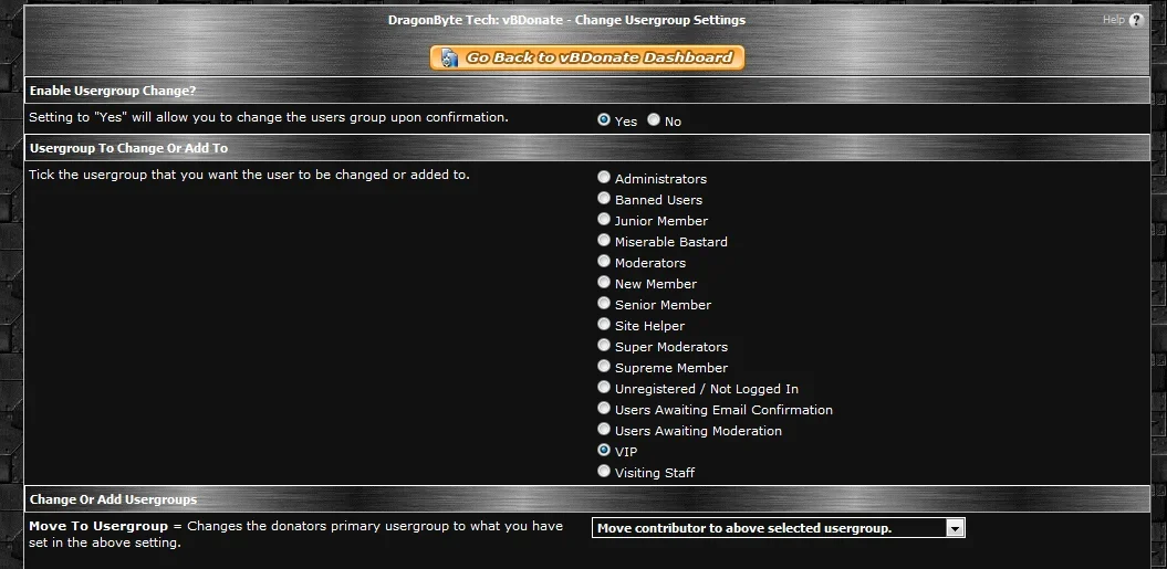

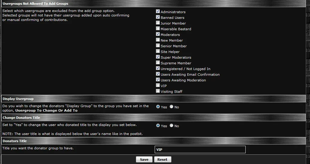

Just a few questions... the first pictures shows the VIP option as the rank the user title they will get... is that happening or not?
The rest relates to the usergroup change... which I assume is the issue you're having? (You have used the phrase 'rank' which isn't what those settings do :? )

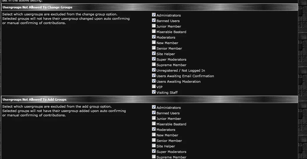

Are you certain the users who are not switching don't belong to one of the groups that can't have a new group added?

The rank that i want it to go to is vip and this is not happening these users are confirmed and they go into that usergroup but the rank doesn't it leaves them as new member rank
now what i have to do is go to acp and go to that particular user and save the settings and then that changes the rank but it doesnt change auto
