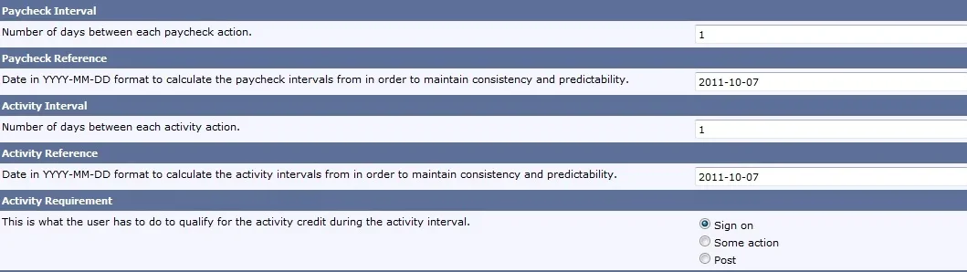

Here's the screenshot of my settings:

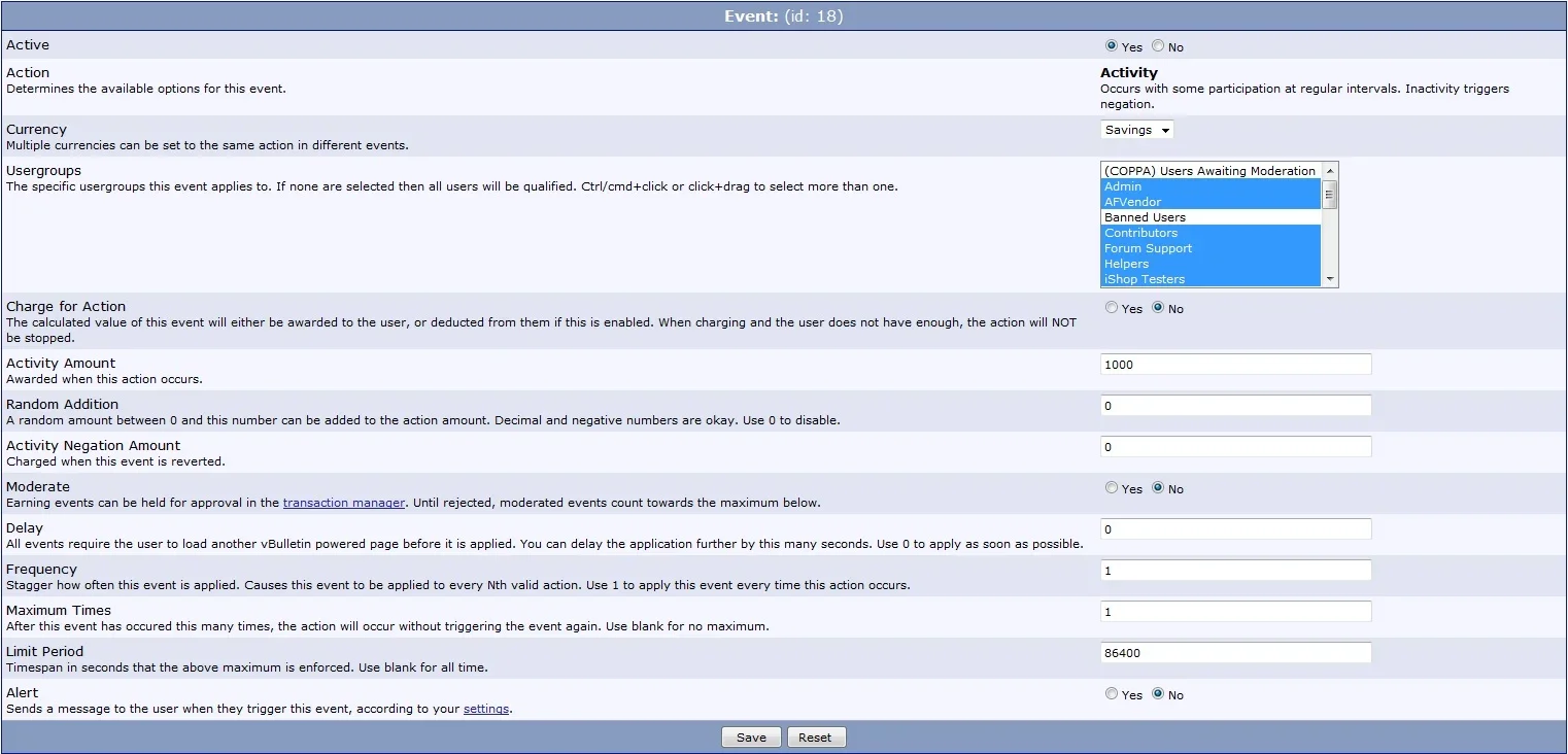

I've enabled the event here on DBTech for just my usergroup, it's currently in the process of catching up with Cosmic's past earned activity. I suspect it'll move on to my activity next.
Update: The event seems to be triggered just fine here on DBTech.
