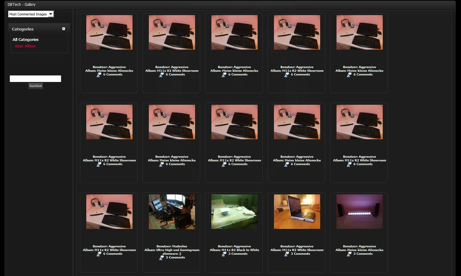

But after importing from vb Albums there is an other one right now.
The gallery displays some images more than one times!
F.e. you have a look at following album: AW-Community
In real there are only 2 Pictures to display.

Can you link me to the source album on that one? I'm not sure why it's creating multiple images.
I figured out the problem and reran the importer on your site. There are a couple duplicates but they're duplicated in the albums as well, threw me off there for a few heh

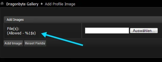

Can you tell me what is the meaning of the following function:
Maybe it´s a kind of bug --> "(Allowed - %1$s)"
You can find it here on DBTech too.

Here is one: Bild 2 von 6 aus dem Album Meine kleine Alienecke
Here is the other same image: Bild 8 von 8 aus dem Album M11x R2 White Showroom
Thanks!
Where are you seeing that? I dont see it on the dbt site or yours?
Thanks for the clarification of the misunderstanding.
Please visit the "Add Profile Image" Link in the sub-navbar.
