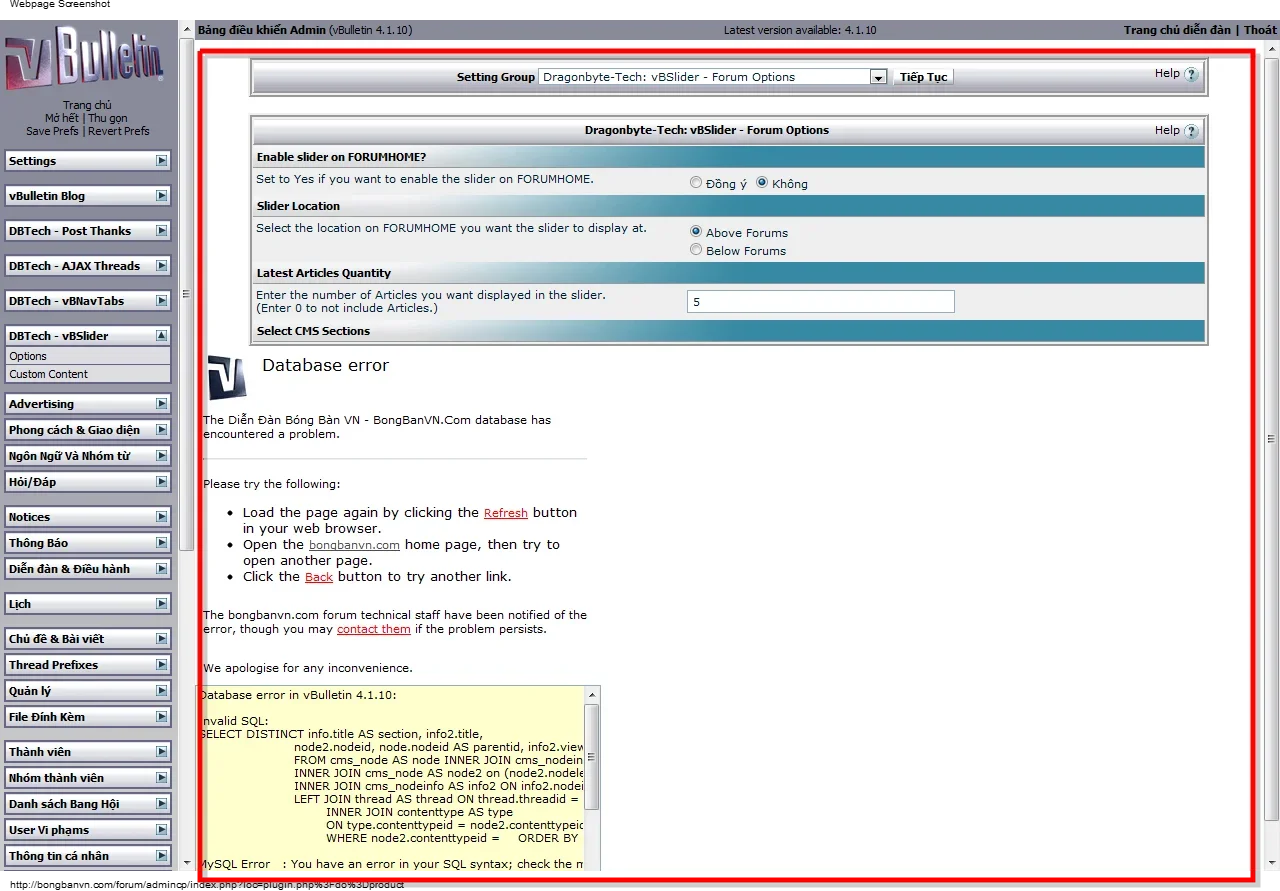

when go to option this is how it looks like

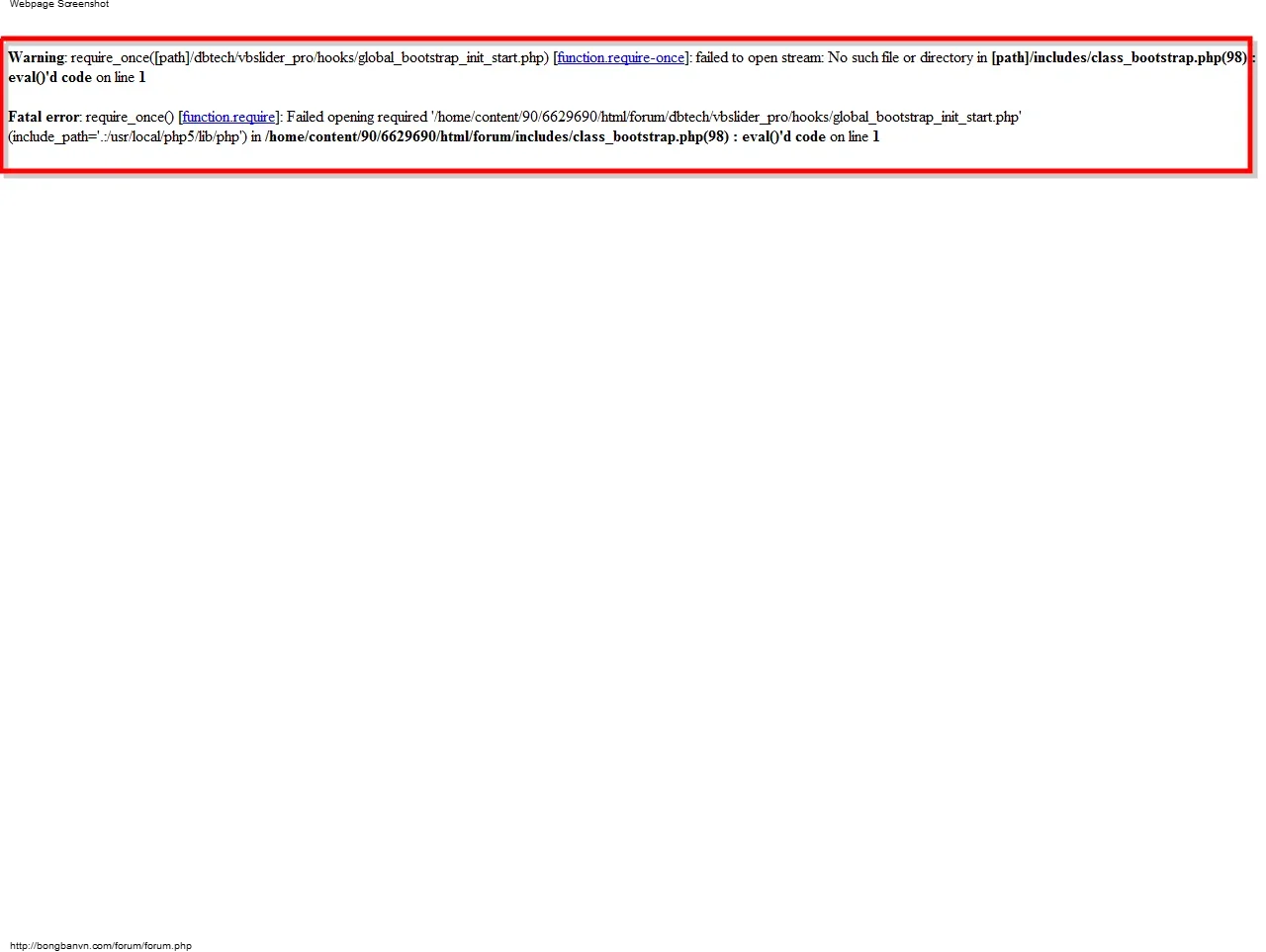

This is a message when I go to my site:
Warning: require_once([path]/dbtech/vbslider_pro/hooks/global_bootstrap_init_start.php) [function.require-once]: failed to open stream: No such file or directory in [path]/includes/class_bootstrap.php(98) : eval()'d code on line 1
Fatal error: require_once() [function.require]: Failed opening required '/home/content/90/6629690/html/forum/dbtech/vbslider_pro/hooks/global_bootstrap_init_start.php' (include_path='.:/usr/local/php5/lib/php') in /home/content/90/6629690/html/forum/includes/class_bootstrap.php(98) : eval()'d code on line 1
and here is the message on option page:...i got message on both CMS Option and Forum Option...it has some of my info I'm not sure if it's safe to post them here.

I have uploaded a new XML file that should correct the error above. If you want to PM me the error, or a temp admin login, I can take a look at it and try to correct it.
---------- Post added at 17:03 ---------- Previous post was at 16:11 ----------
Ok, I've temporarily patched it up to allow you to get it to work. I am still receiving an error in your ACP when changing the options that I am not getting on my dev site, so I need to look at the code some more to see if I can get this fixed. It appears by fixing one issue, a different issue has reappeared. :/
