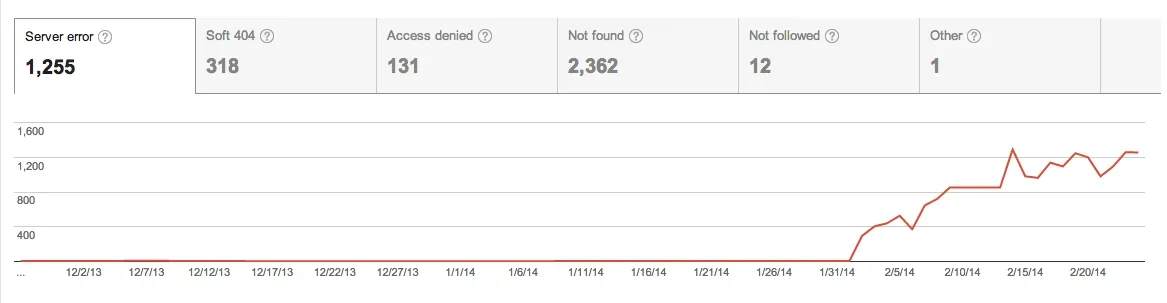

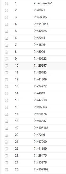

I am attaching the screenshot of the google webmaster tools. From the time I had shifted to DBSEO, these are the errors I am continually encountering.
Some of the URL I am completely not sure if they are ever present at all, but still they are appearing over the webmaster tools.
Can you please help?

Unless you can find the source of those links, there's nothing much I can do. We've had no reports of DBSEO creating broken links like that, nor is it something I've been able to replicate in any available test forum.

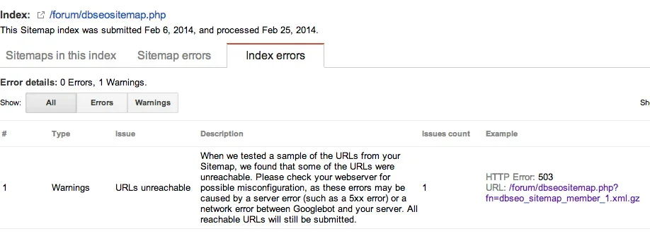

Yes I know, the link I showed above was from webmaster tools only stating that this sitemap is giving wrong links.
Here is another example-
If you see more errors have started coming, when I fetch as googlebot, it comes to be correct. I have also enquired from my hosting company and they couldnot find any errors from server end.

All I can find from the server log is this:
[Wed Feb 26 07:08:17 2014] [warn] [client 66.249.75.155] mod_fcgid: stderr: PHP Warning: Unknown: Failed to write session data (files). Please verify that the current setting of session.save_path is correct (/var/lib/php/session) in Unknown on line 0 =======
66.249.75.155 is google bots IP
If you can help me point it out, it shall be grateful.
Yeah, that's an issue with your server and not DBSEO. Please contact your host and ask for advice, as we are unable to assist with server issues. Tell them that Googlebot is receiving 503 Service Unavailable errors and show them that server log entry, they should be able to assist.
