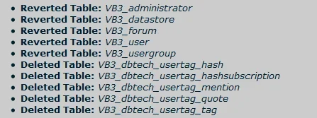

They dont exist?
Ill try uninstalling again and check DB...
Please check the user table for those columns. You are currently browsing tables, I need you to browse to the user table and check its columns.

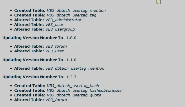

Hi,
I did an uninstall and a reinstall, those two tables were not created.
I had a look in upload\dbtech\usertag\install, couldnt see any creates?
I'm testing the lite version btw.
I'm not sure how else I can explain it to you, sorry :(
