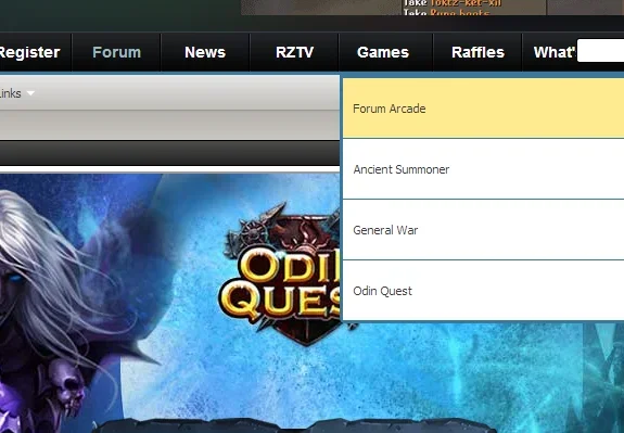

And yet, no drop downs or nothing are working... what am i missing?
I'm confused. Is the merged template your dbtech_navtabs_navbar template that you've attempted to merge with your custom skin?
bottom is default, top is your custom nav dbtech_vbnavtabs_navbar. dbtech_vbnavtabs_navbar wasn't working, attempted to merge style classes and still no joy.
Sorry, I've been very much swamped with DBSEO issues as of late.
If you can PM me with an AdminCP account (no FTP needed for this) and a list of all skins you need me to merge NavTabs into, I can solve it :)
Update: The correct code to use in the dbtech_vbnavtabs_navbar template for BP skins is

Cheers boss but one question, when hovering is it suppose to open on a hover and not a click as with hover selected it still doesn't work until the tab is actually clicked.
To my knowledge there is no such functionality in vBNavTabs. I did not originally code the mod, however, so I could be mistaken - I've never heard of this being a feature at any rate.
