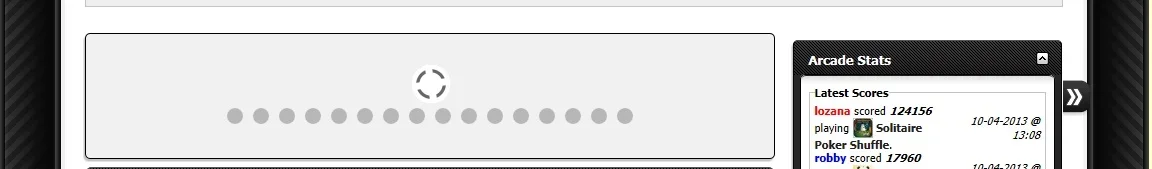

I do not know if is it some bug or maybe some settings in vbslider in admincp - but sometimes I get just loading..loading picture and next click on forum tab I get slider work ...
I reduce images (every image is about max 40-50 kb) but same ...
will attach picture for explanation what I mean. It happened to members (log in ) or for guests.
Also same on default vb skin or some custom skin!
Some solution or help?

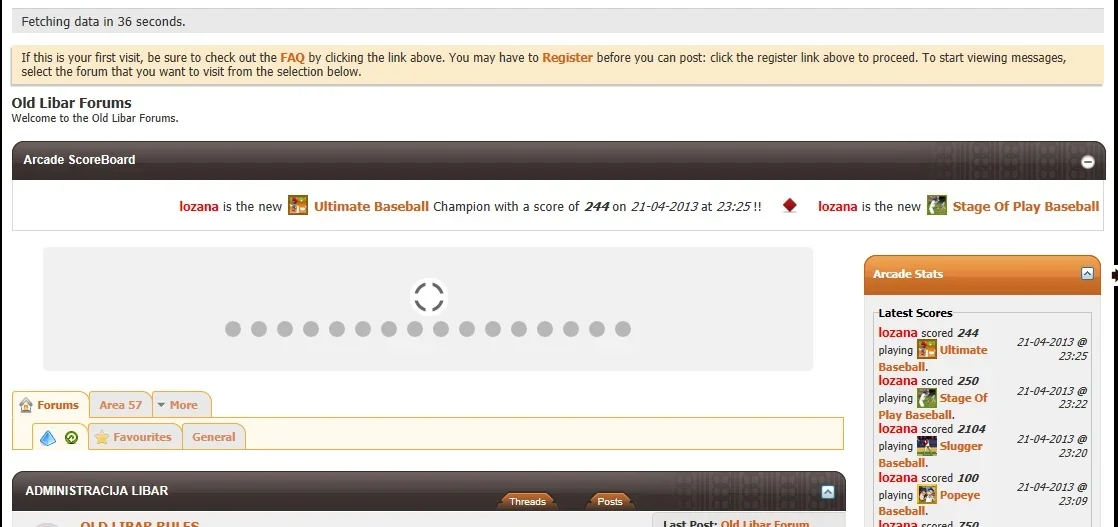

bosss
Your issue is most likely because you had not CHMOD /dbtech/vbslider/images/externalimages and /dbtech/vbslider/images/customcontent to 0777. I have corrected this on your live and test sites.
Thanks! Was CHMOD 0755 - I do sometimes 0777 and server put back 0755.

Hello
Still have same issue ...loading ...loading ...and after click on forum tab ... works fine .... use IE10 (9)
