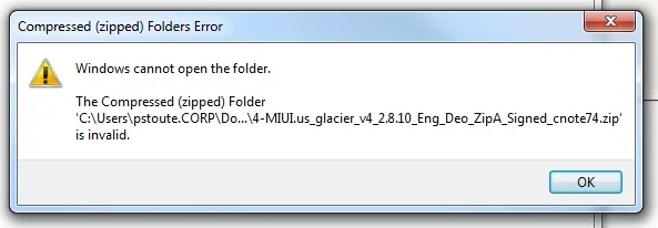

When i try to extract them they state that they can not be extracted.
They extract fine prior to the upload but after upload, then download it will not extract.

this seems to only happen for zip files BTW. The other .php/.exe files work fine. The image below is a screen shot of the error that I get.
Please install a dedicated unzipper like WinRAR or 7zip instead of relying on the Windows built-in extractor :)
