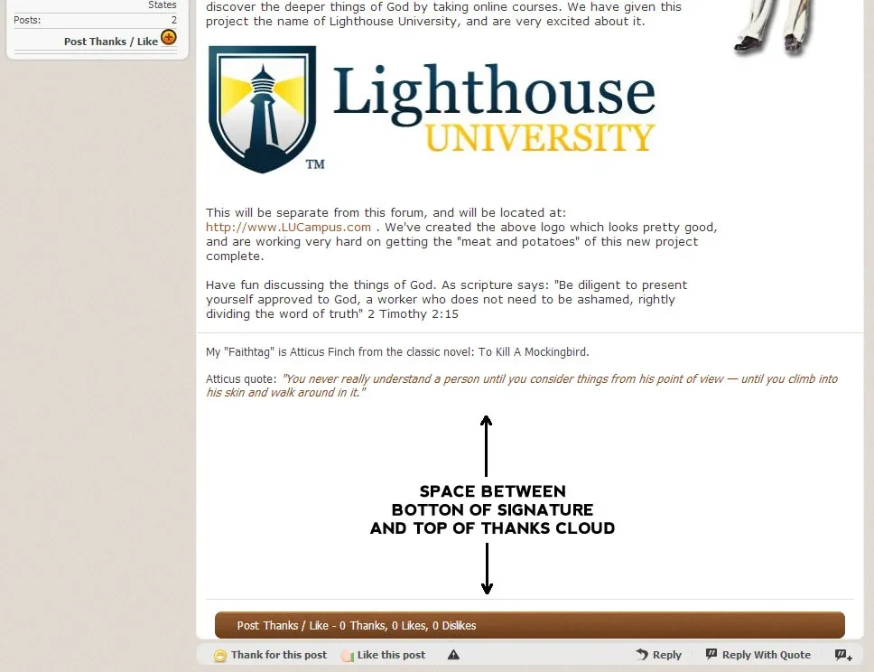

I have the thanks mod installed, and I have the "cloud" set to show up below the signature.
The problem I am encountering is that this setup is creating way too much space between the signature and the post thanks cloud bar.
Below is a screen capture of what I am talking about:
What do I need to do to correct this?

Yeah.. I tried that and it just made it worse.
If you look close, you'll notice that the actual SIGNATURE line is up right under the post content, and is positioned perfectly.
When I deactivate the "thanks" plugin, the posts look perfect. But when I activate the plugin, that's when I get all of that extra space right above the thanks cloud bar.

Oh, I see now... the bottom of the signature space... ;)
Perhaps try this in your additional.css
.signature {border-top:0;}
You might want to contact your theme developer, this is not an issue that appears on the default skin (or indeed our custom skins here at DBTech).
You were correct, Fillip H... it was not in the "thanks" product, but in the other coding. I fixed it so it's acceptable now.

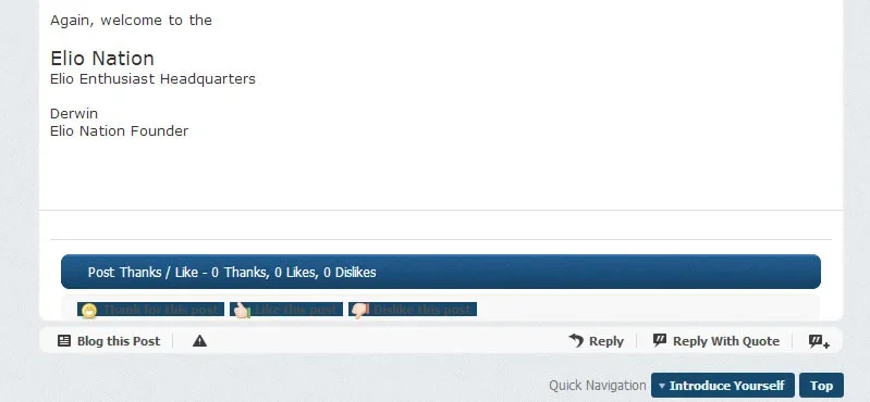

Hello, again! I am installing this in a different vbulletin theme, and it seems that it is using a background color for the "thanks" buttons that is not looking good at all.
Check it out:
As you can see from the picture above, the thanks button is blocked by the dark blue color.
How can I change the button color to white or simply REMOVE the color of the button altogether?
This is most commonly the result of CSS settings, namely the background attribute of the .postbitlegacy .postfoot .textcontrols a, .postbit .postfoot .textcontrols a, .eventbit .eventfoot .eventcontrols a { CSS class, in postbit.css.
To fix it, please try the following steps:
Step 1) Remove all the contents of the postbit_control_background StyleVar.
Step 2) If that didn't fix it, please enter the postbit.css file and find the .postbitlegacy .postfoot .textcontrols a, .postbit .postfoot .textcontrols a, .eventbit .eventfoot .eventcontrols a { CSS class, and remove the background: definition.
Hope that helps :)
Thanks, Fillip H.!
That worked like a charm. But instead of deleting everything, I just went to the postbit_control_background in the Style Variable Editor and chose "transparent", and it shows up great now.
You are the best!
