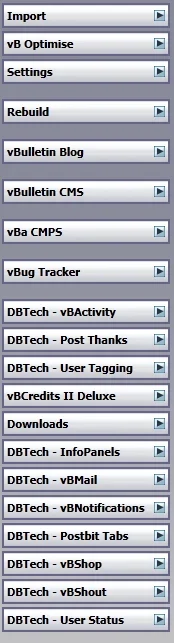

This is how it kinds of look now...:
How can I make it so that it looks a little bit more like this???:

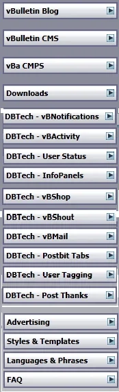

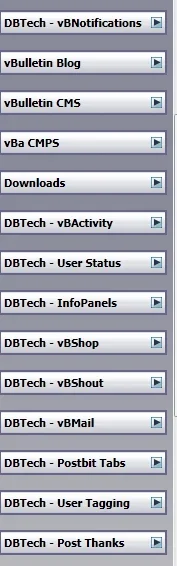

Here is how I've changed it on my test board at the moment...

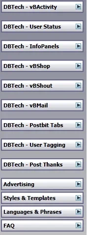

Though this may not be the biggest issue, I believe that all DBTech products released should be bundled in the ACP navigation window. Currently, they are spaced out from each other and, if you have a lot of DBTech products (me) installed, the space that would be conserved here would be considerable.
Don't know what I'm talking about? Open up your ACP and look at the DBTech blocks. See how they have a bit of space between each of them? Now scroll down a bit and look at the default vB blocks. See that space between the DBTech blocks use is far less frequent and only placed in-between logical grouping of the blocks?
