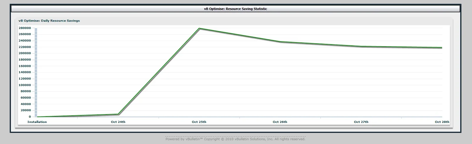

1. No the chart does not load

In regards to the chart not loading, do you have flash installed on your browser? A test would be viewing: http://www.dragonbyte-tech.com/vboptimisesites.php, this page uses the same graph as the one in your ACP but slightly modified.
Yes i see your graph without problems, mine is there just shows no results :-( . I followed your steps for forum blocks and this resolved that problem. Thank you
Hmm, I'd re-download the license again and upload /vboptimise/swf/ folder in ASCII mode via FTP. If that fails I'd only be able to help with a temp admin login (doesn't need to have any perms since vBO is global in ACP) if that's possible.
Hey Blinkster,
I logged on using the details you provided and the chart loaded fine for me. The screenshot is below.
Perhaps you could try different browser? Although it worked in IE/Firefox/Chrome for me.
Using Firefix and don't see it, check browser etc and i have flash installed and even re installed to be sure. Check things my end and try different browsers
I'm not sure what the issue is here unfortunately, the chart is indeed loading and feeding the correct data. If you have Firefox + Firebug installed, is the console reporting any errors?
Shows up in IE ok :-) Will use IE when i want to look at it. Many thanx for your help and for taking a quick look at it.
