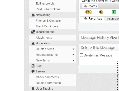

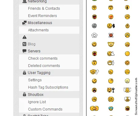

My bad. Everything is fixed, except for the usercp tabs!
Can you provide a screenshot to show me what is messed up? I logged on to your site, but it appears I don't have access to the EditorTabs in the UserCP. And if its a moderation tab, then I probably wouldn't see it anyway...
It is working but the issue remains when editing your smilies in usercp (the navigation sidebar is messed up). Also I have over 1000 smilies and it is IMPOSSIBLE to actually select one. Can we get a new feature for some sort of way to load smilies in pages?
