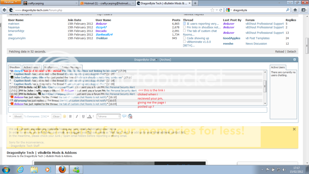

We encountered a problem with pm links in the chatbox not linking to the users inbox, now as ive recieved a pm on here, i thought i would try it and low and behold it doesnt link up to the inbox when i click the link in the chatbox.
Here a screenie of the message i recieve both on here and my own site,
It does indeed work correctly on here.
If I as Ozzy47 click on the one with the red arrow it takes me to the pm in my inbox.
If I as ozzy test click on the one with the blue arrow it takes me to the pm in my inbox.
Now if I as ozzy47 click on the one with the blue arrow, the error message comes up, as I am trying to see ozzy test's inbox.
To elaborate, it works because the SB sends a shoutbox PM from you to the recipient of the PM. The link is correct from the recipient, it's just not possible to hide it from the sender :)
I'm unable to reproduce that, sorry :(
I used the "login to user account" mod and checked it out and it works fine for me :)
The only thing I can think of is that you accidentally clicked one of the PMs surrounding the link you pointed out.
Nope i have just reactivated the pm notifications, and got a test pm sent, clicked the link in the chatbox and same page as in first post...
so at a loss here, the techy has been over the files and he cant find a problem either, they just wont link up for some reason..
Ah crap I remember now, there was some other mod that inserted a new record and screwed up the links...
Check for other mods that run at pmdata_postsave_recipient. One of them is the culprit.
