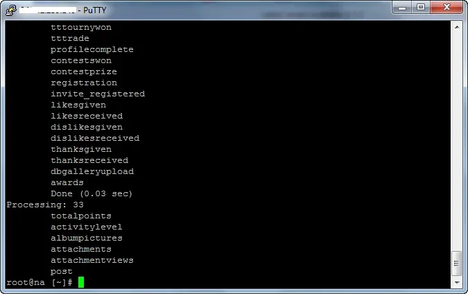

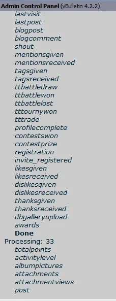

Command-Line Maintenance Script does not working for Recalculate Points , 32 user completed while user ID 33 Recalculate Points process stopped working,Also this issue with DBTech - vBActivity > Maintenance > Recalculate Points,please can you check on this issue?
With SSH
With Admin CP

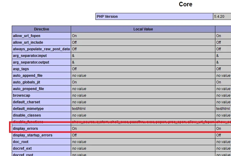

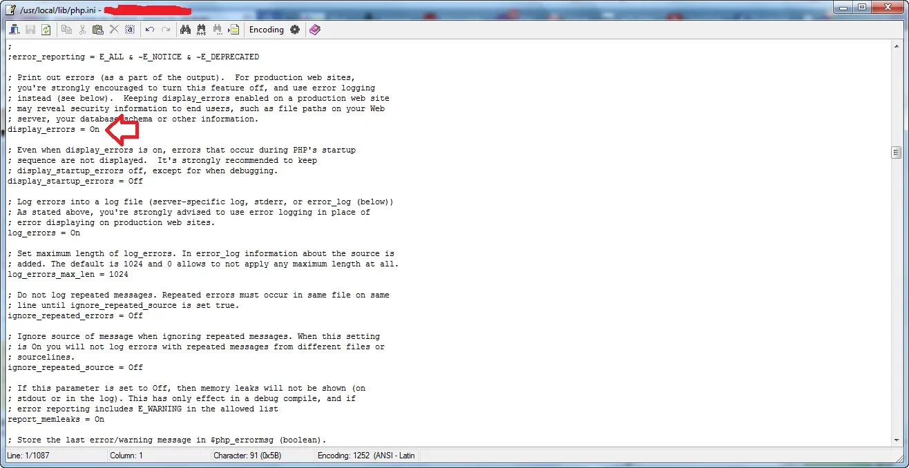

Please turn on display_errors - I noticed your site had this turned off, and without that turned on there's no way I can resolve this issue.
Once you have turned this on, run the script again.
Please ensure you have restarted Apache afterwards, and check the PHP Info page in the vB AdminCP to confirm it is indeed enabled.
