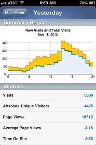

After turning on beta5 and letting it run I have noticed a spike in reported pageviews on Google Analytics. I have been running Google Analytics for a couple years on the site and am very familiar with the expected pageview count and trends for the site and something is definitely off.
I run Google Analytics code (in the footer template), and 95% of my pages also contain Google Adsense Ads (varied places in templates), on top of that I run a Stat Counter script (in the footer template) that also reports pageviews.
Normally, the Google Analytics code and Stat Counter code are very close in pageviews daily and Google Adsense will be a few hundred pageviews less do to some pages not having ad code.
Stats for the last 10 days:
Date: Google Analytics - Stat Counter - Difference
Nov 10: 16478 - 16592 ; diff = 94
Nov 11: 13899 - 13900 ; diff = 1
Nov 12: 12804 - 12743 ; diff = 61
Nov 13: 13507 - 14303 ; diff = 796
Nov 14: 13092 - 13063 ; diff = 29
Nov 15: 12130 - 12235 ; diff = 105
Nov 16: 13997 - 14214 ; diff = 217
Nov 17: 18205 - 18222 ; diff = 17
Nov 18: 16715 - 14348 ; diff = 2367
A couple of the higher diffs above could possibly be attributed to days when I was testing DBSEO (beta3/4) for short periods of time, but I can't say for sure.

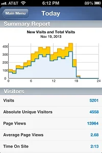

Yesterday Nov 18 DBSEO was turned on around 4:00PM local and was left running throughout the rest of the day. I continued to run DBSEO up until approximately an hour ago. This is what the Google Analytics pageview graphs look like from yesterday and today...
As you can see the spike yesterday coincides from the change from using vbSEO to DBSEO and the drop today (an hour ago) occured right when I switched back to vbSEO. From what I can tell both the Stat Counter reported pageviews and Google Adsense reported pageviews are unaffected - I'm just seeing this spike in Google Analytics. I also can't confirm whether this was occurring in previous betas because I didn't run them for any extended period of time.

I tried working around it by changing the Google Analytics account number stored in DBSEO (to something other than my account). It seems to have partially worked. The pageviews seemed to have returned to normal, but the time on site (avg visit duration) and a couple other stats are still off. I believe these issues still have to do with the second "ga.js" on the page because with DBSEO completely disabled all stats return to normal.
