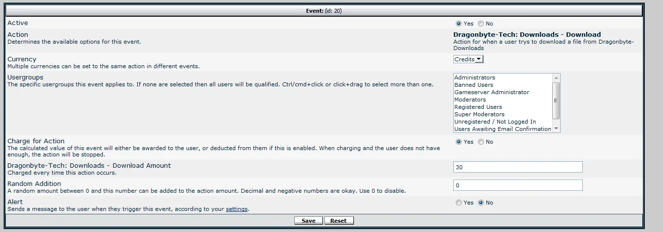

Could you tell me how I can rename
Dragonbyte-Tech: Downloads - Download to something like
Download Section: Download
Thanks alot

I think you can do this by clicking into the action. I'll need Darkwaltz4 to confirm this though.
