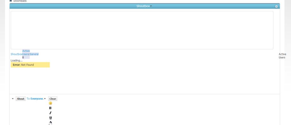

Hi, thanks for that, it helped a lot. It's showing everywhere now, but some of my vB mods, such as vbDynamics, are outside of the forum root, i.e. mydomain.com/forum/downloads, and it doesn't show properly there. I tried uploading the vBshout files to that folder, but then I received an internal server error. It would be really great if I could get it to show there as I can't seem to manage it with any other shoutbox
Thanks for your time
In order to get it to show up in some custom mods, it may be necessary to add {vb:raw show.vbshout_instance1} to that template for the mod.
If that does not work, we are unable to assist with modifying someone elses modification. :(
Hi, yes I've done that but it won't show properly. I was just wondering if there could be a way to change the paths in the vBshout files so they would show anywhere.
Unfortunately that's not possible, those scripts must use a different method to load than the standard vBulletin way :(
