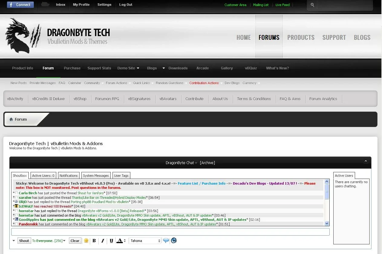

I want to change the shout box location after/below the welcome note and notice box. How can I do it, please help.

As the stolen vBCredits II Deluxe files have been removed here's the instructions for placing the Shoutbox in a custom location:
Step 1: AdminCP -> DBTech - vBShout-> Instance Management -> [Edit].
Step 2: Change the Auto-Display Shoutbox setting to Disabled.
Step 3: Write down the the Varname setting. For the default shoutbox, it's instance1. The rest of this guide will assume you replace instance1 with the actual Varname if it is different.
Step 4: Enter the Style Manager and add either {vb:raw show.vbshout_instance1} (vB4) or {$show[vbshout_instance1]} (vB3) to the templates you wish the shoutbox to appear in.
Follow these steps as described and you will have total control over the position of the Shoutbox.
Please note that some locations may not work as intended on vBulletin 3.8, and also note that it is not designed to go in the Forum Blocks side-bar (vBulletin 4).
We will sadly be unable to give more detailed instructions to produce the exact result you want, so just experiment with various locations in various templates until you find one that suits your needs :)
