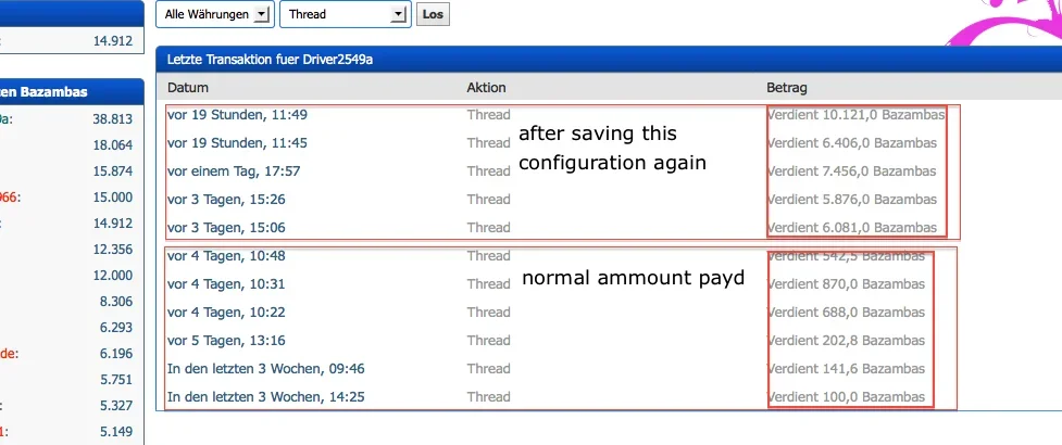

after you explain mee vbshop cant handle dezimals, i get this problem now.
(i use dezimals because you write in the configuration:
Random Addition
A random amount between 0 and this number can be added to the action amount. Decimal and negative numbers are okay. Use 0 to disable.)
so beter remove this note and write "dont use dezimals", if vbshop dont handle this, and vbcredits only make bugs!
i'm add 0,5 credits per word.
after i open this configuration again, i still se 0,5.
i'm saving again, and open again thenn its change from 0,5 to 5
i try this wit , and . > means 0,5 and 0.5
hard to explain whit my poor englisch
thatsway see video :)
www.bazamba.net/vbcredits-thread.swf
not a big problem, solong nobody open the configuration, but only need one misstake and you get trouble whit the users, because on 1000 words you get a verry big different (1000x0,5= 500 1000x5=5000)
i get this misstake now, and have lots of work for fix this on all useraccounts!
Währung - Bazamba Sexforum - Kontaktsuche , Amateure , Bilder & Videos - 2013-12-11_14.26.5.webp
i try all !!!!!!!
0.5 also
see video!
i double check it now again
0.5 save
>>reload
>>save again
>>the 0.5 get 5 again.
