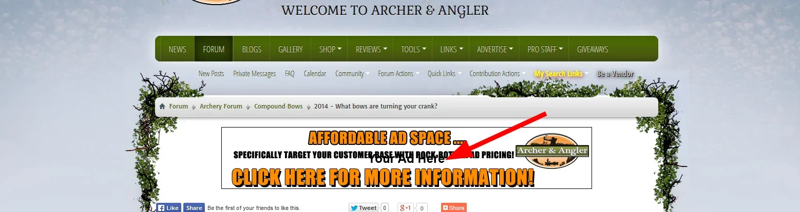

I just noticed this slight bleed through for the "Your Ad Here" placeholder through one of my ads that is a PNG. It is a transparent ad but should still not have this happen.
I am running the pl1 version.

No I have not made any changes to the configuration. I should mention, the screen shot above is an "ad" that I have in place and is not the placeholder.

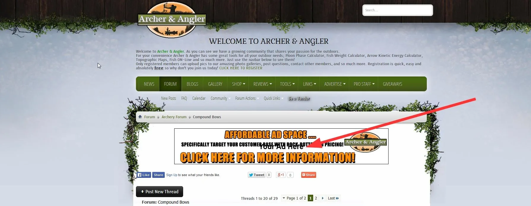

I tested it again in Safari and got the same results. I really believe it is because of the transparent image I am using. Compound Bows_2014-01-08_15-33-17.webp
That picture you have is my placeholder. The problem is with the ad that I have. At first glance they look the same but take a closer look. :)
Can you limit the number of ad spaces in the banner space so that the full ad appears 100% of the time?
While I'm unable to replicate the reported issue, I see that the "Please do not block our ads" image is bleeding through.
Because the background of the ad space is always solid white (unless you edit the CSS), I would recommend changing your image to have a solid white background as well. This will allow the functionality of the mod to remain intact.
If you don't want to do this, you will need to edit the dbtech-wrapper-block-noblockbg CSS class and remove the image from it.
