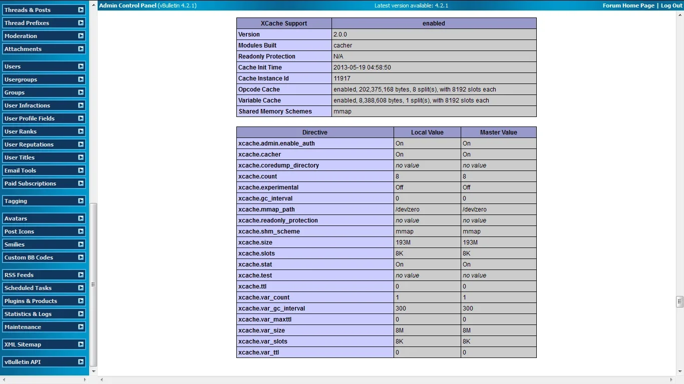

Check your PHP Info page, you can find it under the Maintenance group in the AdminCP.
The reason for this is because you have admin_auth set to On.
Please go to the "XCache Authentification" setting in the "DragonByte Tech: vB Optimise - Misc Options" area and follow the instructions there
Alternatively, turn it off in the php.ini file.
Ensure the password is in cleartext and not MD5 or some other encryption.
