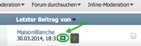

Clicking on the icon (2):
without SEO: going to the last post (ok)
User A: going to page 11 and the last post on page 11 (everything works fine)
User B: going to the first post of page 10 (not ok)
Scenario 2: forumdisplay.php

In Firefox for Mac everything is working fine. In Safari 6.1.3 for Mac not. How could that be?
You have the same problem in the dragonbyte-tech forum: In Safari clicking on the last-post icon lastpost-right.webp doesn't take me to the last post!

You don't need access to my forum. You have the same problem here in your forum at dragonbyte-tech.com.
Try using Safari on a Mac and click on the last-post-icon lastpost-right.webp on a forumdisplay-site and you will see it yourself. Clicking on the last-post-icon should take you to the last post of a thread. This works in many browsers but not using Safari on the Mac. (Instead you are taken to the first post of the last page)
