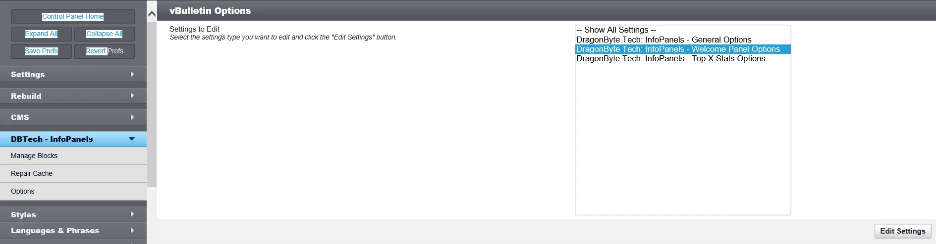

While this may be the case, the attached images (capture1.png - selected item) (Capture.png - the error) show what I am seeing. It looks like a 401 error but it does nto say it is a 401 error.
it says "Invalid Page URL. If this is an error and the page should exist, please contact the system administrator and tell them how you got this message"
