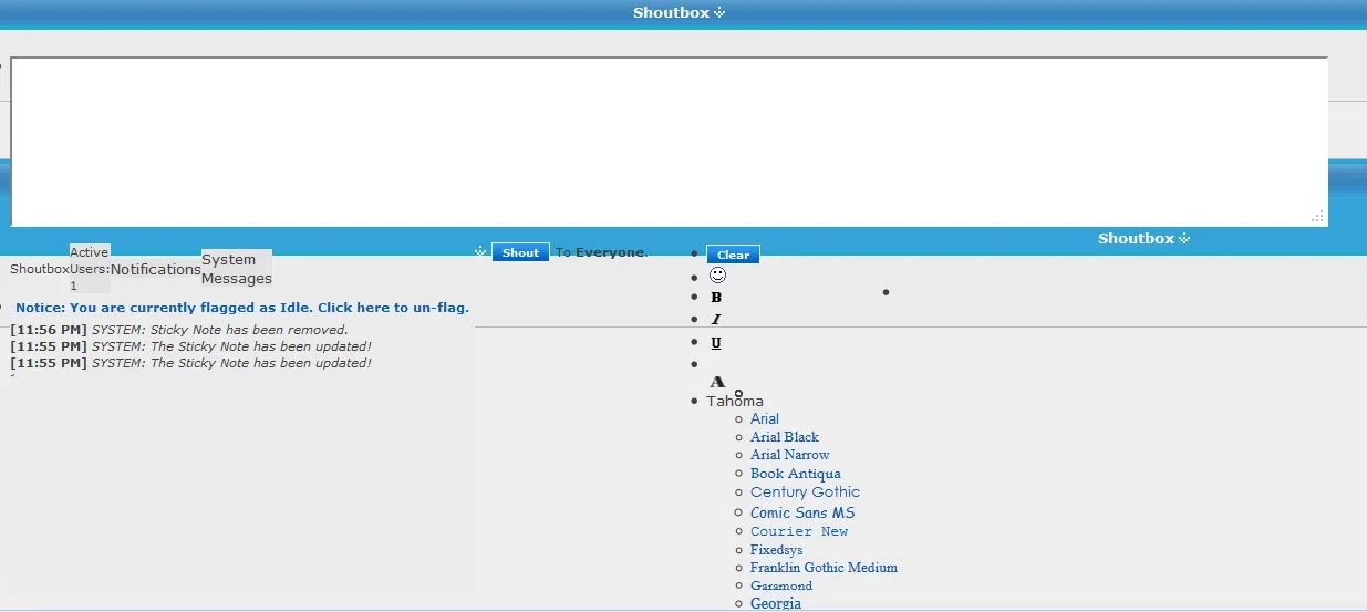

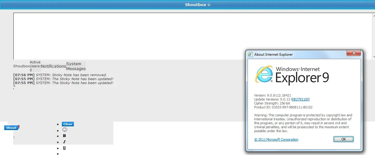

I recently installed vbShout and I am having this strange problem where the layout shows incorrectly. Could you please advise how to fix this?
I am using IE9 and also checked in Firefox same issue on both browsers

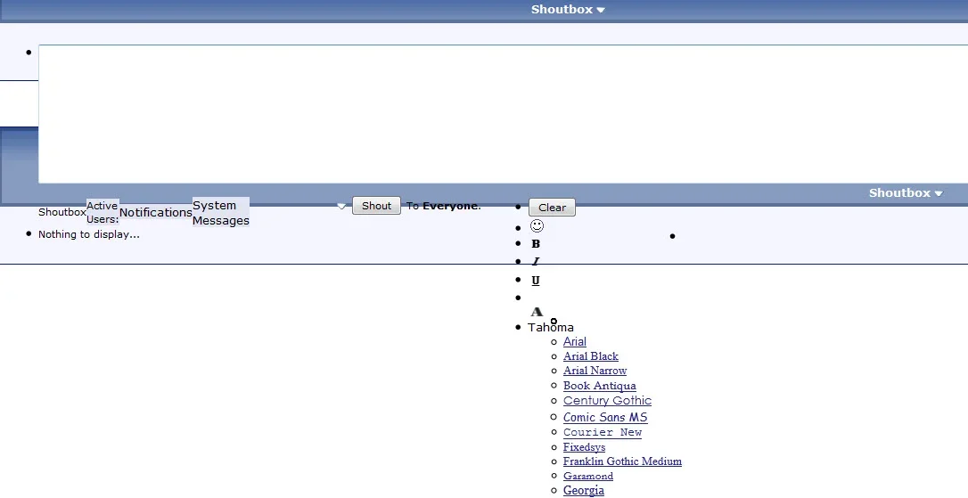

Edit: Default style also has the same issue

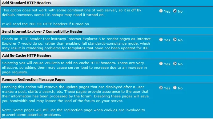

ACP/vBulletin Options > vBulletin Options > Cookies and HTTP Header Options set that to No
Hmm, back to the original question then. Is it showing like that on a unmodified default style?
You may also need to flush the vBOptimize cache and clear your cookies.
