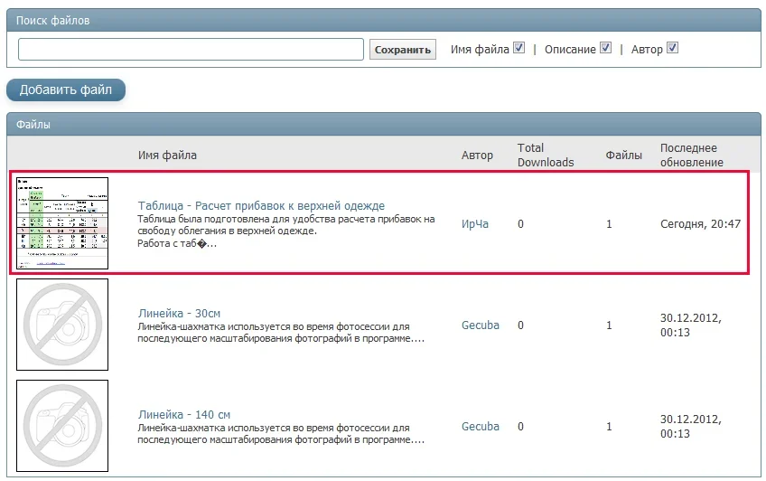

All my old downloads are corrupted now, almost all files don't have thumbnails, and even if dowload has thumbnail in a category list - it doesn't appear on download's page:

Almost all my old files were with thumbnail only (not 'screenshot') and now they are look the same - NO IMAGE...
