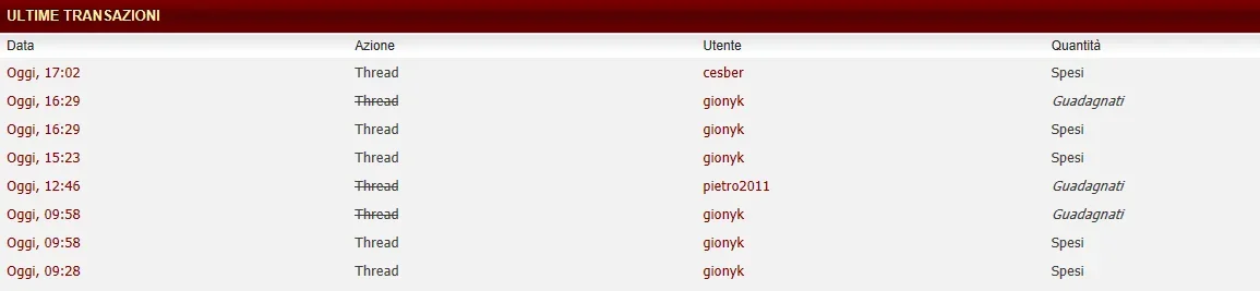

Hi at all :) , the first think sorry for the english not perfect now i try to explain my problem , the credits system must to charge 2 credits every time a user open a thread in " Cover request " section and this action work good and the system charge 2 credits normally , when the request is processed i go to the thread and write near the title for example " The Gladiator [request processed ] " , some times when i do this the system charge other 2 credits at the user , i have tried in many ways but nothing change ( From administration tool , adding a prefix etc etc ) but its the same . How can i do because the system works well ?
You need to configure the "Negation amount" setting to be the same as the amount of credits you award in order for this to work as intended.
Tank you very much i have done this and now the system work well but i am looking that now the system make this 1) charge 2 credits when user open a thread , 2) charge 2 credits when i edit the title , 3) add again 2 credits . This is a normal behavior ? and if is normal can you explane to me why ? In the transaction page i see this : Cattura.webp . Tank you again for the support
It is indeed normal, the reason for this is that certain parts of the event can modify the amount of credits you're given, so in order to maintain integrity, whenever you edit a thread or a post (etc), it'll undo the old event then re-apply it to re-calculate the amount of credits you need.
