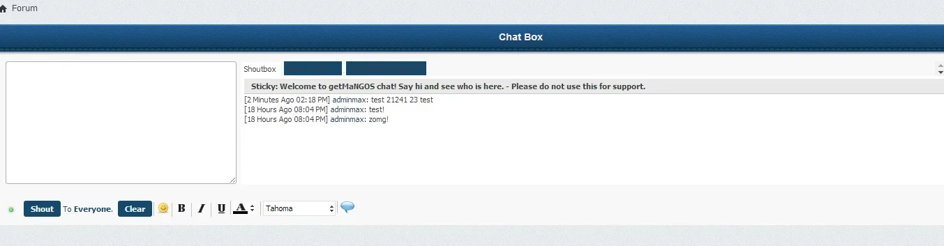

1. vbShout - Using the "Primus" theme the tabs in the shoutbox seem to blued-out, you can't read them without making them active (see screenshot).

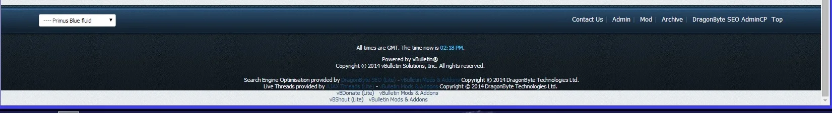

2. The Dragonbyte footer copyright would be better if it was put into one sentence with a button/link to click which opens up a box that list's the Dragonbyte products installed.
The theme we currently have (Primus) has a footer image... it is not adjustable in the CSS it is fixed (so i've been told by our developers), as can be seen in the attached screenshot or live on our site.
If possible would you be able to look into having a link to a small popup box for cases like this? As it stands the copyright of the last 2 products is barely visible as is, so it would make sense to have a small box with all products listed.

1. Change the .formcontrols .blockrow .dbtech_shouts .dbtech_vbshout_tabs.alt and .formcontrols .blockrow .dbtech_shouts .dbtech_vbshout_tabs.alt2 in the dbtech_vbshout_colours.css CSS Template to customise the colours.
2. You can install our Copyright Management mod to condense the copyrights to one line :)
