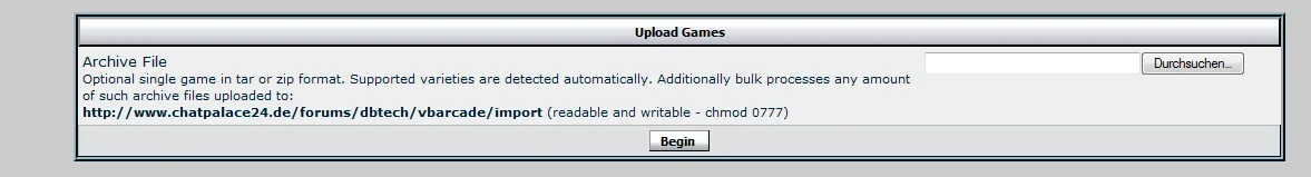

for importing games , you have to upload the .tar , .zip from ibproarcade or v3arcade into you import folder : /dbtech/vbarcade/import
rights have set to 777 .
After all settings done,you can click import and your newly imported GAmes are in there.
