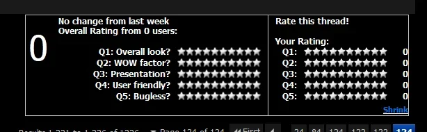

Hi there, on some of my forum skins the ratings box does not have nicely rounded corners. Can someone perhaps help me on getting that back?
Thanks.

That is really weird. Is there not something I can add in the additional.css to force it in these skins?
Can you give me a link to a thread and a style where it is happening and I'll take a look at it.

Its an issue with border-collapse in the main CSS roll-up file. If you add "border-collapse:separate" to that element, then it works.
Edit the following template in whatever styles don't work: dbtech_trating_thread_bits_expanded
On the first line, find the following:
<div class="table" style="background: {vb:raw trating_bgcolor};<vb:if condition="$trating_corners"> {vb:raw trating_corners}</vb:if> border: {vb:raw trating_border}; padding: 3px 15px 0 15px; ">
Change to:
<div class="table" style="background: {vb:raw trating_bgcolor};<vb:if condition="$trating_corners"> {vb:raw trating_corners}</vb:if> border: {vb:raw trating_border}; padding: 3px 15px 0 15px; border-collapse:separate;">
