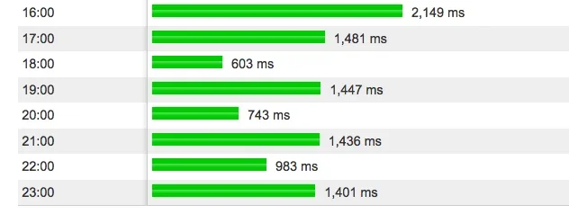

We're using Memcache and this setting was at 3600 as a default when we installed vB Optimise 3.2.0....
vB Optimise: Global Cache TTL
On large sites, the data cached may begin to amount to a large size. To help maintain a limitation on this, vB Optimise can use the built-in TTL ("Time To Live") for your selected extension with the seconds specified here.
This is helpful especially towards extensions which do not "delete" data when Flushed, but simply flag them as expired.
The default setting is 3600, which equals one hour. To disable this setting simply enter 0.
I notice that when checking our site using Pingdom tools HTTP remote check, that the "Response Time" report seems to show an increase one hour, followed by a decrease the next hour and then back up (increase) the following hour etc.
In other words, it looks something like the pic attached....
If 3600 = 1 hour, is it possible that setting is causing the cache to flush out every hour, which means it starts over for the following hour?
I've temporarily set t at 7200 (2 hours?) to see what happens ....
We don't have a large site, so could I turn this OFF altogether (set to 0)?
Thanks ...

You could turn it off yeah, though I'm not sure if it'll have any side effects. Try it out and see if you notice anything acting weird :)
No, the only thing that could happen is things like forum name changes or somesuch might not show as updated for everybody.
Roger that .. :D
I've had it at 7200 overnight and I was actually thinking this morning when analyzing the response times, that it appears a bit slower than at 3600. Is that possible?
Perhaps it was just the Internet being slower around the world overnight, as we use Pingdom tools for checking response time, which accesses our servers from cities all over the world and gives us high, low and averages etc.
