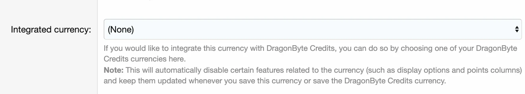

In the Shop currency, if this setting is set to None:
This issue would occur due to an issue with rounding vs display decimals.
If that setting was set to an actual Credits currency, this issue does not occur.
It will be fixed in the next version.
You're right about the shop currencies. This "integrated currency" setting was never set apparently, but we have them pointed at the same database column. This explains why it wasn't happening on my test forum because the setting is used there. Quick question: will it break anything if I change this setting now even though both add-ons have been in-use for some time now?
It will not, it'll simply make Shop transactions show up in the Credits transaction log (events will be auto-generated when they are needed) - and of course this bug will be worked around :D
