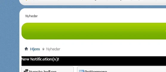

I've installed this tonight and the only thing I'm getting is a black bar across my FP with "New Notification(s)" - and this is not clickable.
Problem exists in both customized and default skin.

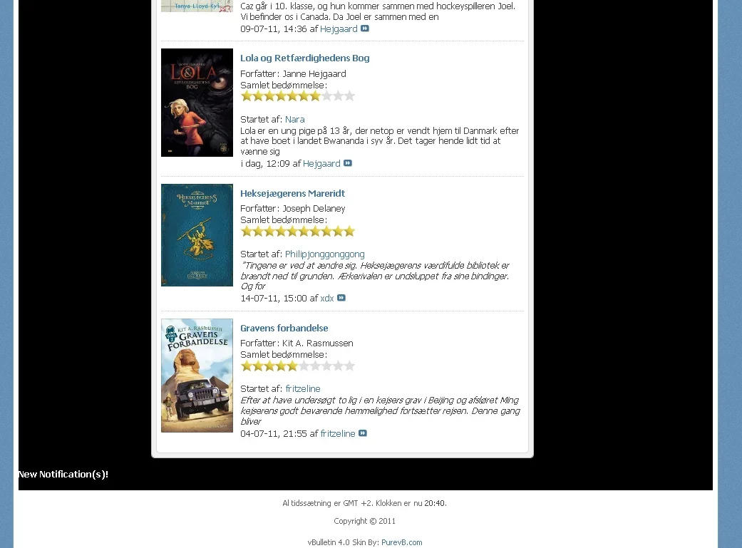

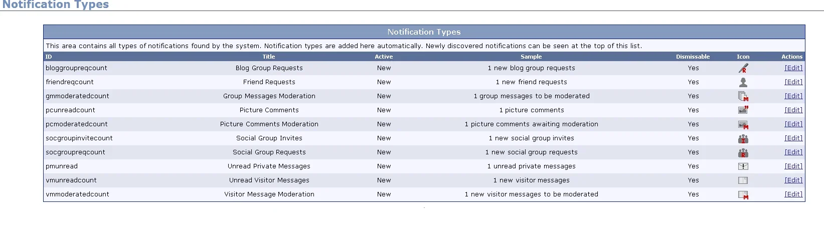

Edit: jsut found out that the black bar is only showing for admin. When logged in as user the entire background on FP has turned black, see att.
