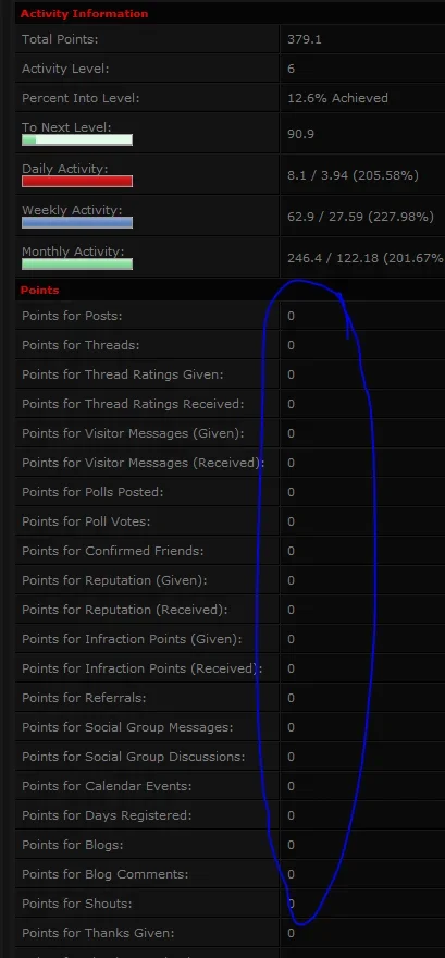

Points field all Zero.
Please execute the following query:
DELETE FROM dbtech_vbactivity_points
Remember to add your table prefix as found in your config.php file. If your tableprefix variable is "vb_" then type "vb_dbtech_vbactivity_points" in the above query.
Then, run the following script:
/admincp/vbactivity.php?do=finalise&version=2000
Let that run to completion and the problem will be fixed.
I get this error when trying to run the query:
An error occurred while attempting to execute your query. The following information was returned.
error number: 1146
error desc: Table 'thebull_CreativX.vb_dbtech_vbactivity_points' doesn't exist
My table prefix is vb and that is what I added
EDIT: My apologies! I added vb_ instead of just vb
Running the script now.
