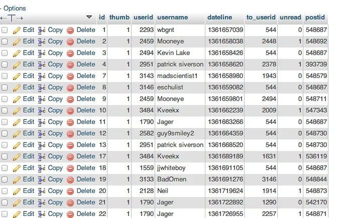

I attached a screenshot from the table I am using.
You think you could have a look at your script and replace whatever needs to be replaced to get it to work?

Can you please be more specific than "the count is off"? There may be a re-calculate feature I can have you run, but I won't know without more information.
Attached a screenshot.
On top are the counts from the other mod. Below yours.
Here is also the part of the code I changed from the script. Might have something wrong there also.

Have you tried running the Rebuild Statistics and Recalculate maintenance actions under DBTech - Post Thanks (run them in that specific order)?
ha...I figured it out.
What I did is probably not the easiest way but it worked.
I made a copy from the table from Scandal's mod and named it post_thanks (as it was called in Abe's mod).
Then I modified your import script as I had one different field name (the one I changed is in BOLD)
$thanks = $db->query_read_slave("
SELECT thanks.*, to_userid AS receiveduserid
FROM " . TABLE_PREFIX . "post_thanks AS thanks
LEFT JOIN " . TABLE_PREFIX . "post AS post ON(post.postid = thanks.postid)
WHERE id >= " . $vbulletin->GPC['startat'] . "
ORDER BY id
LIMIT " . $vbulletin->GPC['perpage']
Ran the modified import script and ran the maintenance options.
Perfect match now. No differences in the counts

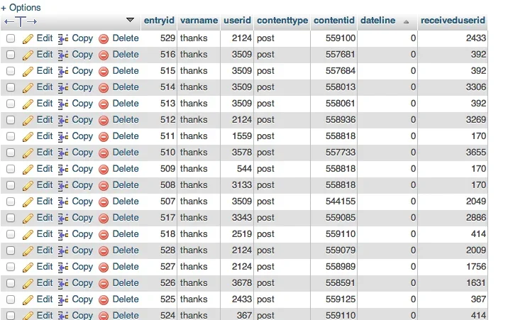

Looking into the table "dbtech_thanks_entry" it is populated with the data from the import (see screenshot).
I recalculated all points and achievements but the users didn't get any points for their thanks given/received. I started to recalculate from the date we started our forum.
The only time somebody got points is when I clicked on the "Thank you" button in a thread manually.
Am I missing something here to get those Thank You points from the past implemented?

The issue is the dateline column - as you can see, all entries from Scandal's mod did not get correct date stamps added. I'd suggest you make a similar change to the "to_userid" change in order to correct this, then delete all entries with dateline = 0, then run the importer again :)

I found the reason why the dateline field didn't get imported.
If you look at your original script it uses the field "date" which is not existing
PHP:
while ($thanksinfo = $db->fetch_array($thanks))
			if ($existing = $db->query_first("
				SELECT entryid FROM " . TABLE_PREFIX . "dbtech_thanks_entry
				WHERE $thanks_column = 'thanks'
					AND userid = " . $db->sql_prepare($thanksinfo['userid']) . "
					AND receiveduserid = " . $db->sql_prepare($thanksinfo['receiveduserid']) . "
					AND contenttype = 'post'
					AND contentid = " . $db->sql_prepare($thanksinfo['postid']) . "
					AND dateline = " . $db->sql_prepare($thanksinfo['date']) . "
replaced "date" with "dateline" in my script and now it got imported properly:
PHP:
					AND dateline = " . $db->sql_prepare($thanksinfo['dateline']) . "
As a result the point are calculated also in the "activity" mod and the Leaderboards show correctly
Sorry for all the trouble but I guess maybe you can use it to include an import script for Scandal's mod with your mod...
