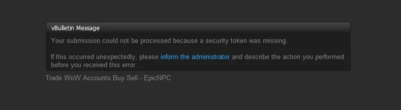

When someone purchases credits, they receive this error when they are redirected back to the site after Paypal payment.
Everything works, credits are received by the buyer, but I'd like to fix the error message so it doesn't come up. It would be nice it the buyer got a "successful purchase" message instead.

I'm guessing the issue is that PayPal has started sending the redirect back to the site as a POST request, which triggers the security issue.
To be honest, I'm a bit stumped as to how to resolve this without opening up a gigantic security hole by removing the Cross Site Request Forging protection altogether... I can't rely on the referrer, as that can be spoofed quite easily. The same applies to the referring IP address.

At this point in time I can't think of a solution on my end, because the change to a POST request happened on PayPal's end.
Update: I've just realised a potential fix for this issue. Please open /credits.php and change
PHP:
if ($paymethod = preg_replace('/\W/i', '', $_GET['method']))
to
PHP:
if ($paymethod = preg_replace('/\W/i', '', $_REQUEST['method']))
and let me know if this works for you.
