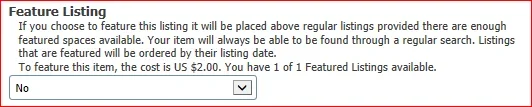

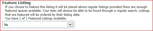

The fee amount does not show until you preview your ad. First pic is before the preview and the second pic is after. I have tried everything but I cannot seem to get it to work. I've notice on this site it is working like it should. Any ideas what might be causing my issue?
before:
after:
I guess I could try an overwrite reinstall of 1.1.1 and see what happens. As it sits now members would get a surprised fee for featuring an ad and I don't need that. :)
I've had a quick look and tested it on my dev site, and it shows fine for me. Can you try rebuilding your cache to see if that resolves the issue? :)
I've tried rebuilding the cache and that doesn't help either.
FYI: I did not try a reinstall since you thought it wouldn't help.

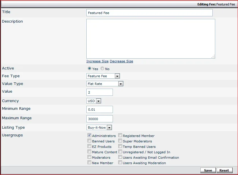

I just installed 1.1.1 lite on a bare bones 4.2.2 PL1 test site and I get the same problem I have on my live site. I have attached a pic of my setup for the feature fee. Do I have something toggled wrong or is it correct?
Just traced the problem back to a check that is done as to whether there is a usergroup for a fee or not. This is fixed in the next update (1.1.2), hopefully released tonight. :)
