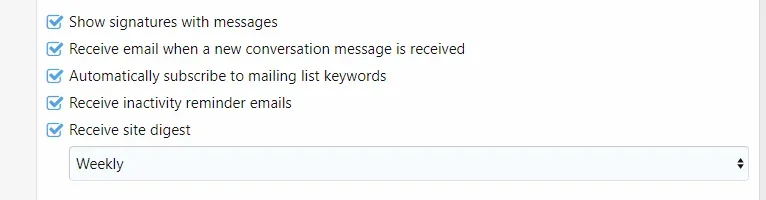

just curious since i set up a digest, but i haven't received anything in my email inbox. test digests work fine. i see the cron job is running every few hours, but it's unclear to me if anyone is actually getting my emails.
it did finally show up a few hours after my last post. when is the cron job set for and when does the digest get sent out to users?
The digest cron runs every 10 minutes. By default, users receive the digest every 7 days, though you can configure the default in the Digest settings and users can choose to receive the digest in various increments via their UserCP as you saw.
where is that 7 day mark determined? just curious. like, are all the digests sent out to all users at the same time? or is it 7 days from when they registered? since the cron is running every 10 minutes, im guessing not all digests go out at the same time, or maybe not even on the same day?

The first time the mod is installed, no-one has received the digest, so every 10 minutes it will try to send as many digests as it can until every user has received it.
After that, it looks at the "last received" time stamp and compares it with the "frequency" to work out whether any given user should receive the digest.
Correct, depending on the size of your forum it can take hours or days before everyone has received the first batch, and afterwards their future recipient dates are determined by their first recipient date.
