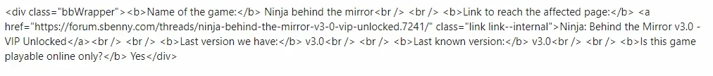

Help please, each thread/post on the forum turned out to this after the upgrade.
I'll try rebuilding the Thread's cache if it'll work, sad to see this.
Solved by completing the pending upgrade, but I'm not sure it this should've happened. I was upgrading DragonByte Shop and all the threads/posts turned to this until I completed the upgrade, is it normal?
The template modification in Shop that dealt with post styles was changed a while ago in order to increase compatibility with other addons. It would probably be normal to see something like that temporarily, yes.
